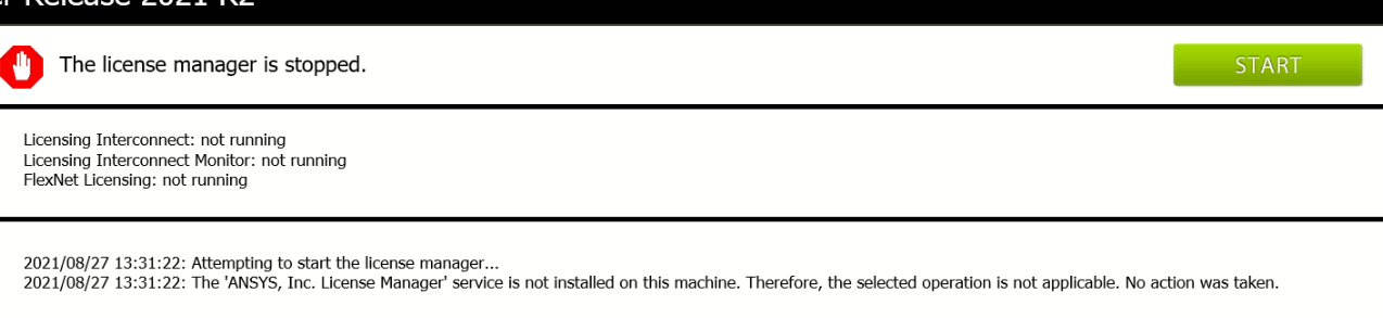

? This post originally contained file attachments which have been removed in compliance with the updated Ansys Learning Forum Terms & ConditionsHello, Â i am trying to install the licensemanager, but somehow i am not able to do this, any idea why? See attachements for more information. -

SubscriberSubashni Hello, i have solved the problem already. I had installed it as admin, but somehow not everything was installed. I have copied the content from the folder: C:Program FilesANSYS IncShared FilesLicensingwinx64 from my pc to the customers pc and now everything works.

Forum ModeratorPaesc It could be that some install files got corrupted during download or otherwise. In case this issue occurs again please feel free to raise a service request on Ansys customer portal
