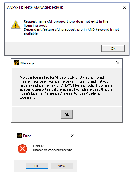

      I installed Ansys 2022 R2. My workbench, CFX, Fluent is working fine. Only CFD-Post, ICEM-CFD not working.
      It is showing the following error. I checked the user license preference as well, it is set to default.
      Could you please help me to solve the error.

      Can you post the contents of the license file you are using?
      (Increment lines only)
      You may need to have the License Administrator download the latest license file.
      Under %TEMP%\.ansys, you will see *.out files and log files.
      Scan those for error messages and please post them.
    • Ankan Dey
      Thank you for your help, its a license feature missing from the pool of license.
