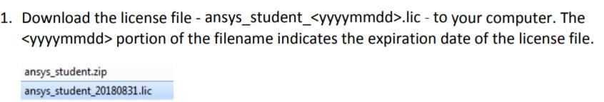

      Hi, where can I download the license file?
    • tsiriaks
      Where did you get this instructions from ?
      I'd recommend to follow the steps here
      /forum/forums/topic/how-can-i-renew-ansys-student-version-license-1/
      if you want a new license.
    • 959011
      These instructions are from my university. I thought I would be able to get this file directly from ansys support but i got sent here.
    • tsiriaks
      ANSYS Student license is actually 'built-in' in the ANSYS Student version installation packages that you can find here
      https://www.ansys.com/academic/free-student-products
      so, you should not need these extra steps, just download and install the software and the license will be included there.
