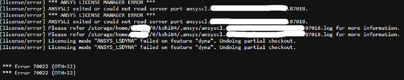

        I found a non-usermat package of of LS-DYNA with the same version, parallelization, and linux version as the usermat package I am using. I copied the ansyscl file from the non-usermat package and put it in the same directory as the solver executable. Running the same solver and keyword file resulted in a slightly different license error:
        I am not sure how identifying this output is, so I whited out things I thought could be. I could not find the log files in the path provided by this image. Do you believe this is an issue stemming from the software side, or the computing cluster I am using LSrun on?

        • igandiko
          Please try setting ANSYSCL_BIND_TO_LOOPBACK=1 and ensure there are read, execute permissions to the directory where ansyscl is located.
          Are you using Ansys license or LSTC license to run LS-DYNA? If its Ansys, note that env ANSYSLMD_LICENSE_FILE should point to the license server.
          Its probably better to run a simple non-usermat ls-dyna job to make sure your license settings are correct.

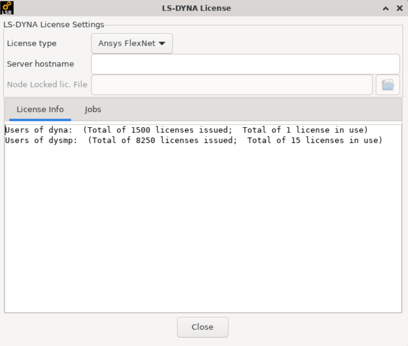

      Looking at the license tab in the ls-run window:
      Unfortunately, I do not have write permissions the location of the precompiled solvers. Perhaps I can ask them to move it for me.
