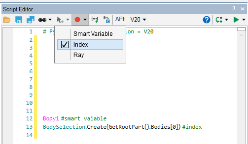

    • Aniket Chavan
      SpaceClaim is a direct modeler while DesignModeler is more of a classic history-based Modeler. SpaceClaim is being developed actively, while the DM is now in maintenance mode along with scripting in DM.
      C:\Program Files\ANSYS Inc\v212\scdm\ should have more resources under the API versions folders with names such as SpaceClaim.Api.V19 etc, have you taken a look at it?
      later can store smart variables, and is encrypted, so can't be read in text editors
      resources at answer 2 should have examples there.

    • Aniket Chavan
      smart variables are variables with metadata, with short names unlike the index-based variables for entity selection.
      -Aniket
