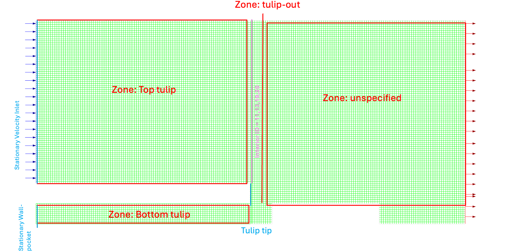

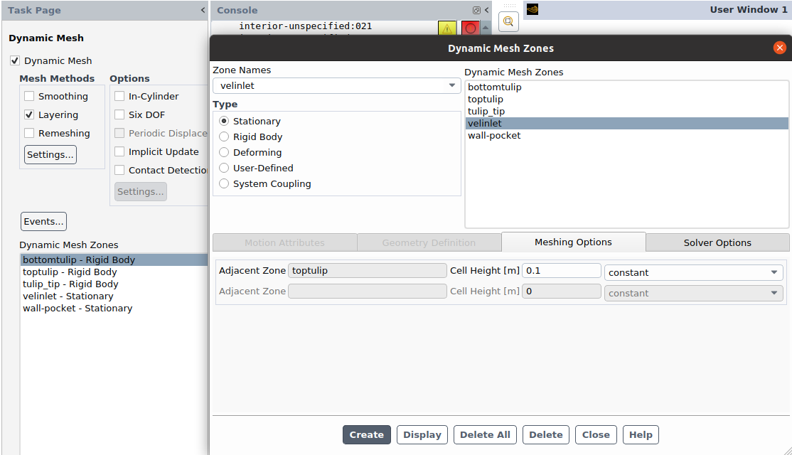

Hope all is well with you. I am trying to incorporate a rigid body motion via Layering, but I observe that the cells are being stretched instead of split for a column cells that are interfacing between 2 fluid zones (similar integration problem here:https://innovationspace.ansys.com/forum/forums/topic/problems-with-dynamic-mesh-settings-while-mesh-motion/)
I tried varying the split and collapse factors. Since the cells are collapsing but not splitting, I think the problem is related to how I set up the interior cell motion. From other documentation and tutorial videos, I think I need to specify a mesh interface between the two fluid zones, but I'm not able to conver the internal zones into a mesh interface. Do you have suggestions on this? Thank you again so much!
Screenshots of inputs and sim case is below; averge cell height is 0.01m:

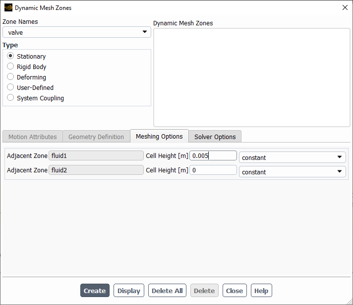

In order to have cells splitting/collapsing, you need to define a cell height on which the split/collapse factors are calculated on. If you have an internal face zone between your fluids, set this zone as Stationary and specify the cell height in the on the corresponding side that should split/collapse.
For example, if I have 5mm layers and I want these layers to split on the fluid on the left (fluid1), I should create something like this:

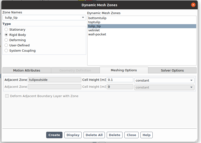

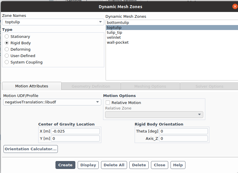

bottomtuplip, top tulip, tulip_tip have rigid body motion, translating to the leftÂ
velinlet, wall-pocket are stationaryÂ
Thank you!!

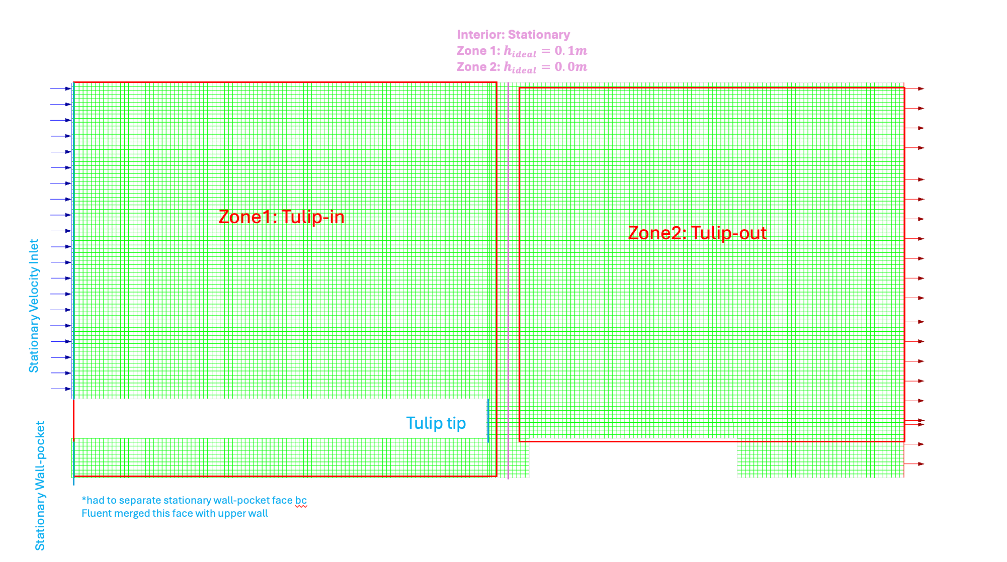

Subscriberapologies- misread your first mesage. I hope this image below clears up the confusion of the boundary conditions:
I did set interior zone and interior boundaries (I've seen them as "internal boundary conditions" but they have ID's 11,13,19,20 as shown) to be stationary, but the tulip rigid body's negative translation created negative cell volumes.Â

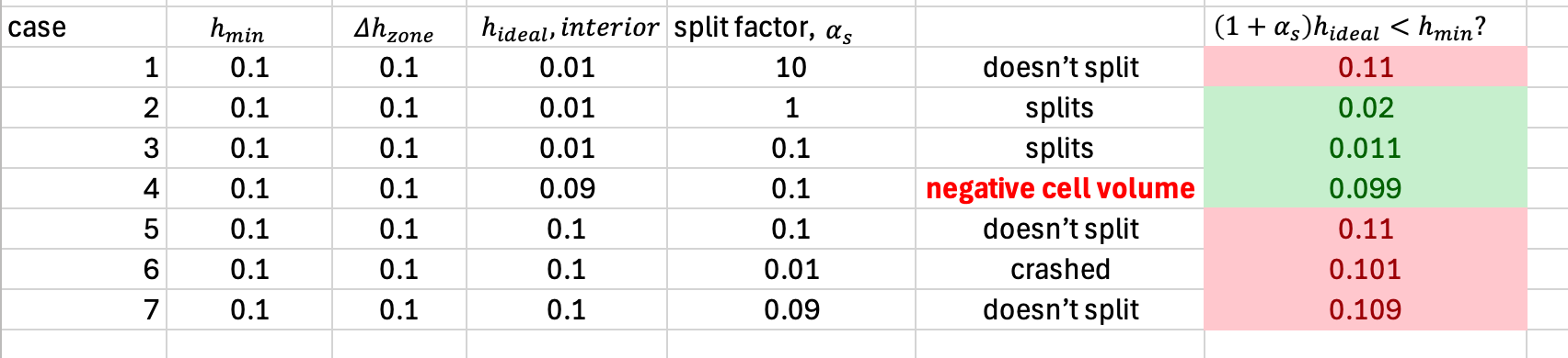

when I set these interior boundaries with a the same negative translation UDF and varied the cell height (under "meshing options") and the spilt factor per the manual instructions; h_min > (1+alpha_s)*h_ideal, splitting only occured when h_ideal was much smaller than h_min. Consequently, the cell layers were bunching together. Table of tested parameters are below and screenshot when i used case 3 parameters. h_ideal_interior
I couldnt find a cell height for the interior zone that did not result in bunching (denoted in table by \Delta h_interior zone). Changing the cell height (denoted by \Delta h_zone) did not change the lack of splitting either.Â

If you specify an alpha_s or h_ideal that is greater than h_min, then splitting won't occur! To pick a h_min, you need to find the zones that are adjacent to the dynamic boundary condition. To do this, I strongly suggest labeling all your zones because its very easy to confuse zone names if they're all called "unspecified"Â
I started with a 1 zone, but separated them into 3 zones ("out-tulip", "bottomtulip", "toptulip") and multiple interiors that were between my zones. The third zone ("toptulip") was a fictious zone that had 0 cells. This third zone was adjacent to the actual zone, which is the h_ideal that I needed to split my cells.Â
To specify my dynamic boundary conditions, "inlet", "wall-pocket" were stationary. "bottomtulip", "toptulip", "tulip tip", and the interior zones were given a rigid body motion. For the BCs with the rigid body motion, I specified an h_ideal (or cell height) that satisfied Eq1. If you specify the interiors or "out-tulip" as stationary, then these layers became fixed and induced negative volume cells. Â
To pick a h_ideal, I calculated what new "h" I would have (table below). I chose a alpha_s = 0.1 because I wanted to make sure my cells were split.Â

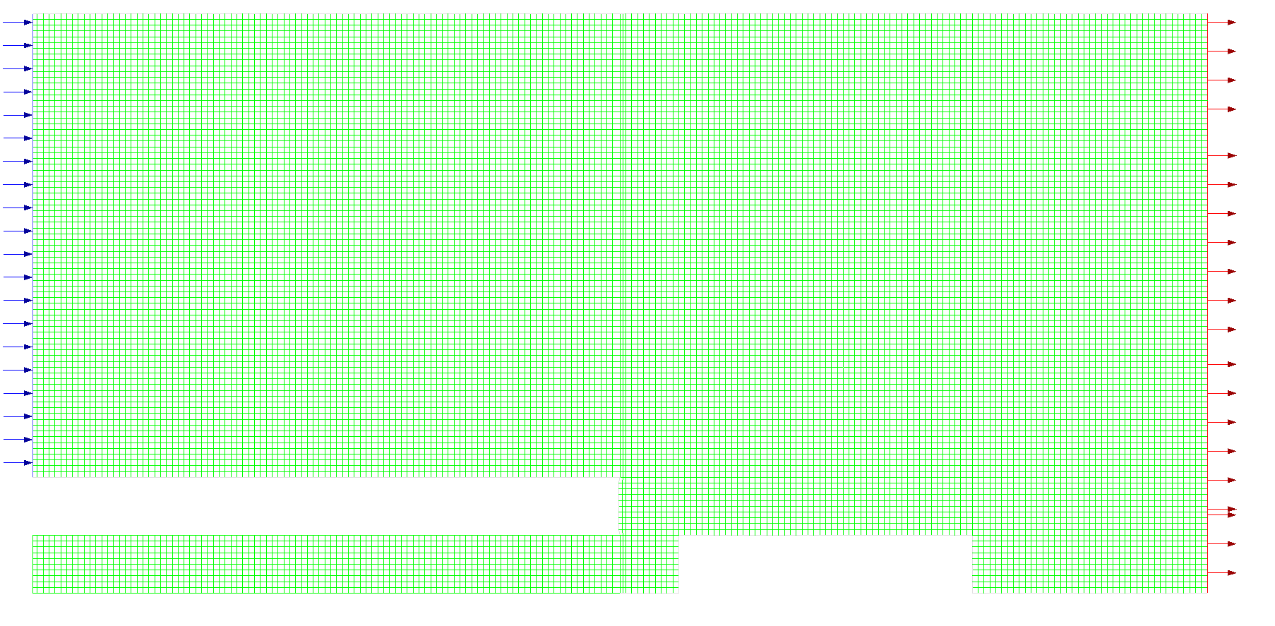

For a case like this, I would set the entire fluid cell zones top_tulip and bottom_tulip with right body motion, and have internal face separating with the rest of the domain as Stationary with the corresponding Meshing Options to have layering occur here (Best practices is to have layering occur in a non-moving boundary).
February 9, 2025 at 9:27 pm
zoelle.wong
SubscriberThank you for clarifying!Â
For future users: this set up (image below) worked better! When using dynamic layering, make sure your zones are contiguous! Above, I had two moving zones, but when I merged these two zones together then I didn't need to reverse engineer a h_ideal value as I did previously!Â
