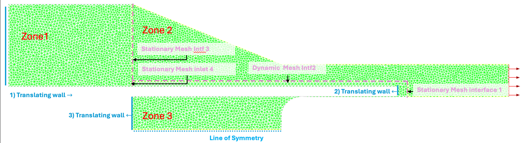

Hope all is well with you. I'm trying to implement 2 layering zones inside my simulation both of which are occurring at the same time. I get a SIGSEGV error with the message "free(): corrupted unsorted chunks." I don't think my UDF is a problem because I tested it on a simpler dynamic case, and didn't get this error. I think my error comes from how I specify the boundary conditions but I wanted to double check (see figure below). My question is: Is it possible for two touching zones to layer in opposite directions provided that the mesh interface between the two zones are stationary? Thank you again so much!

hard to tell without having the labels for each dynamic mesh zone on your screenshot. I assume that both walls translating to the left move together, right?
If so, this motion is possible. Horizontal interfaces should be set as Deforming. What is interior-tulip-border?

Ansys EmployeeI am referring to both walls moving towards the left. They need to be moving together for layering to work.

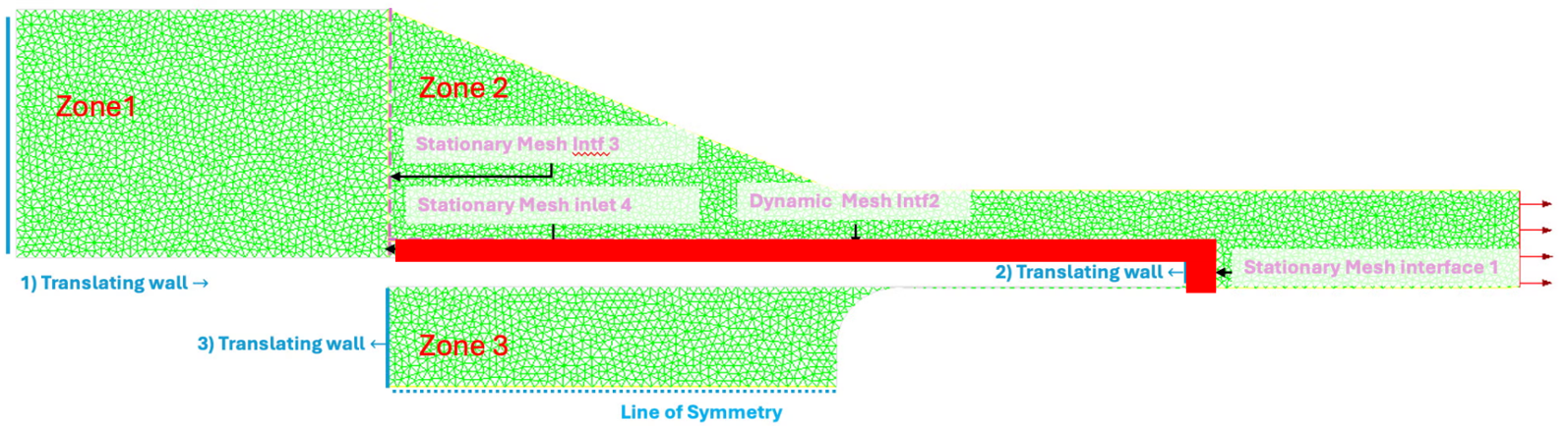

Have another follow up question: This time, I need to have a very small gap distance between two walls as seen in the figure below. Zone 1 will be a block of structured cells in the final simulation. I'm running into trouble with Zone 3. I need a very small gap distance between the two walls, and FLUENT can't generate a mesh interface at "mesh inlet 4".. (looking into this and will prob post another follow-up question about this).
My thought process is to either (1): prescribe the interior of zone 3 as a block of unstructured cells that are "deforming" rather than "layering" or (2): split zone 2 into 2 blocks, one consistenting of structured cells and the second consisting of  unstructured cells. Would (2) be more stable than (1)?

Regarding your latest question, we should look into why you cannot generate a mesh interface at Mesh inlet 4. I’ll look for your next post.
Here is what I would suggest:
Make a separate zone (red below). Let’s call it Zone 4. Zone 4 should be structured mesh, to allow layering. Set mesh inlet 4 and Mesh interface 1 as Stationary and have Zone 4 with Rigid body motion. You should see collapsing layers at Mesh inlet 4 and adding layers at Mesh interface 1.
Have Zone 3 with the same Rigid body motion. You can leave it as unstructured if it is easier for you to achieve a better quality mesh, since Zone 3 will be moving rigidly.

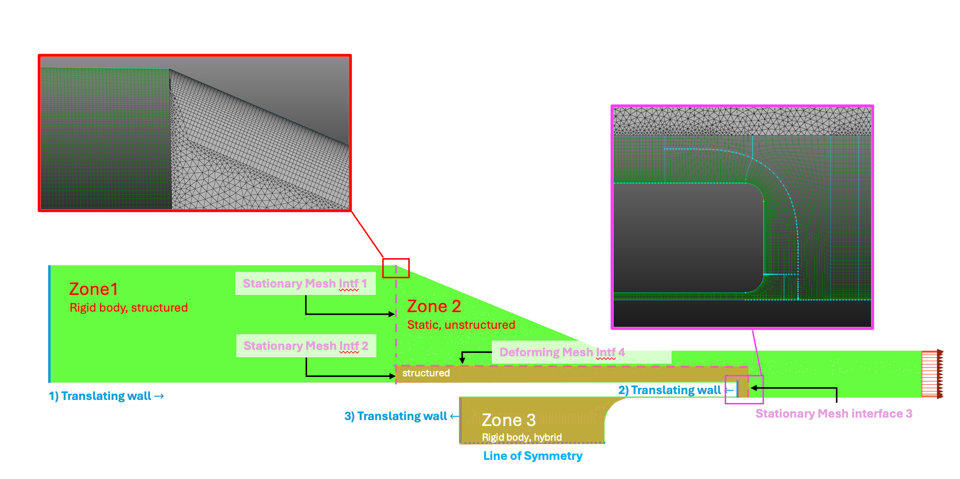

Good news: I got the case above to work (just had to change the mesh quality in certain areas) and it looks super cool!! I had to make the mesh as closely structured as possible.Â
Since posting previously I had to implement cell refinment to account for boundary layers. Consequently, it's harder to force the mesh to be structured; I included layers of structured cells near mesh interfaces (1), (2), (3) to help with layering. The semi-good news is that I got Zone 1 in the figure below to layer but I can't get Zone 3 to layer. The mesh BCs are the same as discussed previously and I get the message "cannot create surface from sliding interface zone" Â or a seg fault error. I'm not sure if it's because mesh interface 2 is a triangular mesh next to a quadrilateral mesh. Would re-meshing zone 1 to have have structured cells near mesh interface (4) help?

Subscriber[Update]: Making zone 3 to "deforming" instead of "rigid body motion" did not result in a SEGSEV error, but new cells weren't being made at walls (2) and (3)
