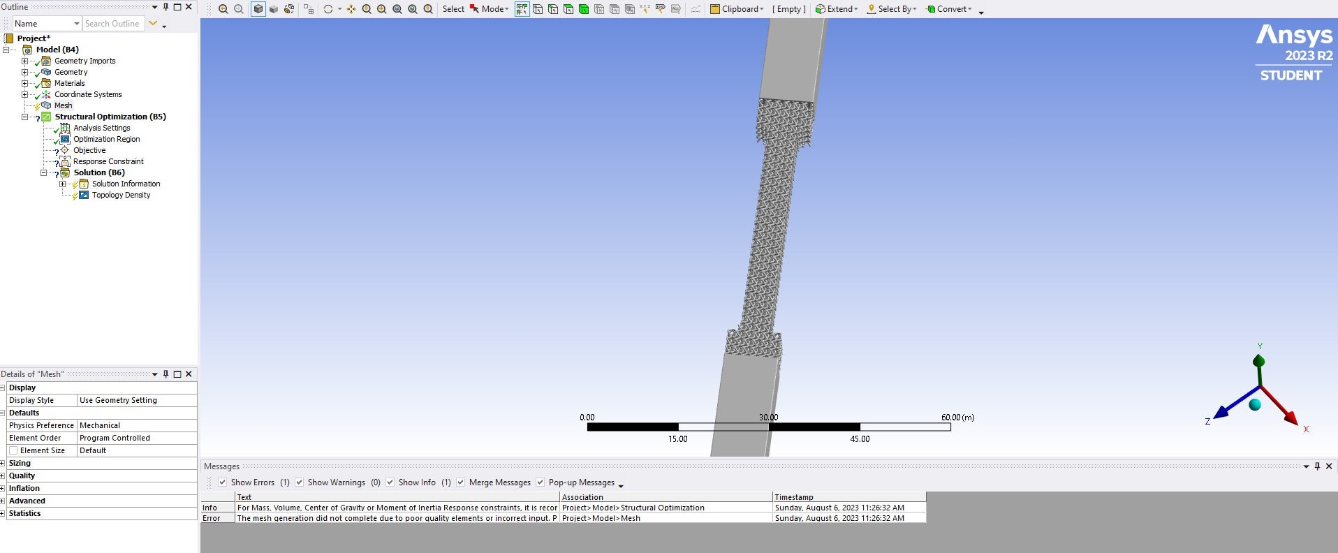

SubscriberI want to prepare Explicit Dynamics Simulation for tensile specimen which manufactured with lattice structures. I created my geometry with lattice structures commands in SpaceClaim. The program creates surface geometries ,so i convert geometry solid firstly. My problem starts here. I don't use lattice optimization for this project. I meshed this geometry but there was a problem in solution. It could not be solved. So i tried element numbers. I think the smartest solution for this problem , modelling this geometry with shell or beam elements, but two cylinders are solid ,lattice structures are surface. So it can not be solved with explicit dynamics. I am waiting your help for my problem.Â

SubscriberI tried run both shell and solid bodies at the same model but the program take an error about this situation. Lattice structure models can be very complex as in the attached files, meshing can be very hard. I found the mesh modul about this problem at the another program. It's working principle show in an attached files. I have to do in ANSYS what this module is doing.

SubscriberThe lattice as seen is solid not hollow so one would need solid elements to mesh, but I can appreciate that it can be hard to mesh.

August 6, 2023 at 3:39 pm
August 6, 2023 at 5:02 pm
peteroznewman
SubscriberThis geometry is so complex that even after you get a valid mesh, you will not be able to solve it because the node and element count will exceed the allowable limit of the Student license.
