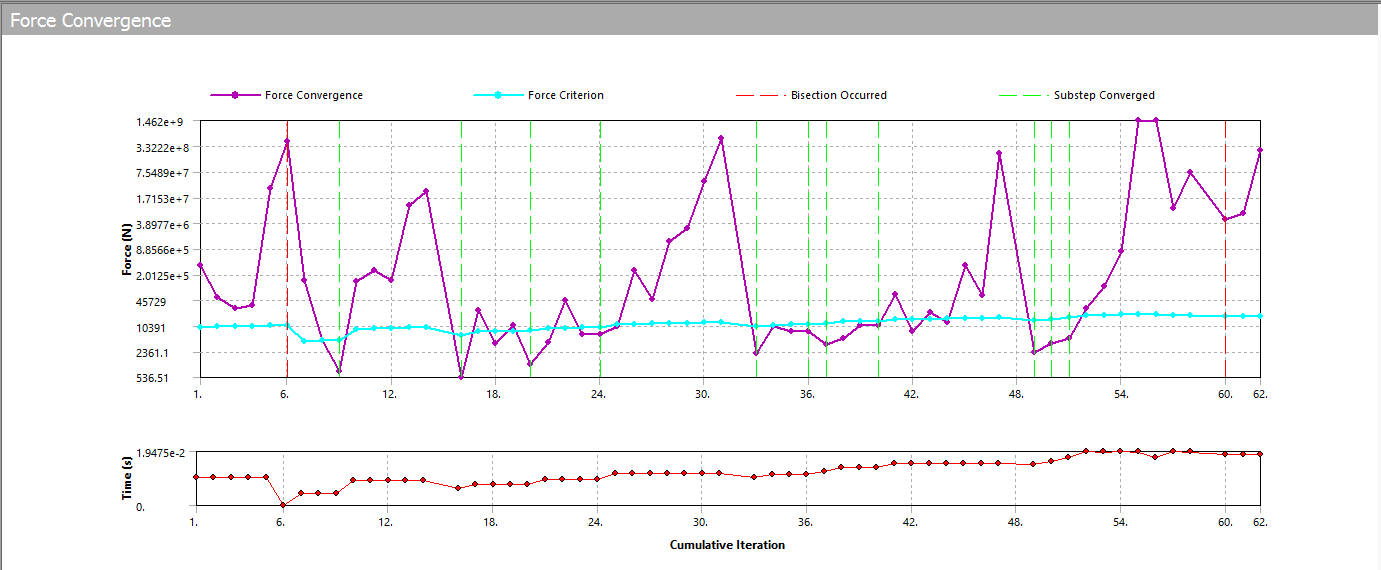

SubscriberHello everyone!nI solve a problem with thin shells, with a static calculation I have no problems, when I connect large defomations, I have no solution convergence. How can convergence be improved or what could be the problem?n -
February 27, 2021 at 11:46 pm
peteroznewman
SubscribernUnder Analysis Settings, turn on Large Deflection. Turn on Auto Time Stepping. Set the Initial and Minimum Substeps to 100, and the Maximum Substeps to 1000.nClick on the Solution Information folder and type 3 into the Newton-Raphson Residual plots in case you fail to converge.nReply with an image of the Newton-Raphson Convergence Plot.n -
February 28, 2021 at 10:07 am

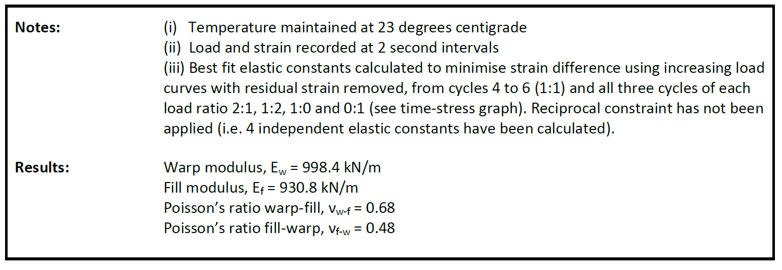

March 4, 2021 at 7:52 pm
peteroznewman
SubscribernOn sheet 1 I can see the UTS, but what you want is the Modulus. Do you have a copy of MSAJ/M-02-1995 to see how that test is performed?n -
March 4, 2021 at 8:12 pm
March 5, 2021 at 4:49 am
peteroznewman
SubscribernThis is a woven fabric, so there are different properties in the Warp and Fill directions.nWhat is the sheet thickness?nWhat is the fiber material?nWhat is the binder material?nDo you have the material properties of the fiber and binder?nANSYS has ACP/Pre that allows you to define a composite material and put fibers down in two directions and hold them together with a binder.n -
March 5, 2021 at 5:51 am
Evgenii_K
SubscriberACP / Pre, I have already checked it will not work. To solve the problem, I need to convert the units of measurement to MPa and assign the properties of the material in the third direction. But those properties of the material that I have, they are not required for Hill's fluidity, for this task the stresses radiated during stretching and sliding are needed, and this experiment must be done three times, but I only have this data with them and I need to work with them. The question is, how can the experimental data be reduced to MPa and is it possible to take voltages from the diagram ?! The diagrams that in the report I converted into an electronic version and tried to use them in the model of hyperelastic materials, but here too, failure.nMaterial thickness 1 mm, base material polymer reinforced with fiberglass meshn
