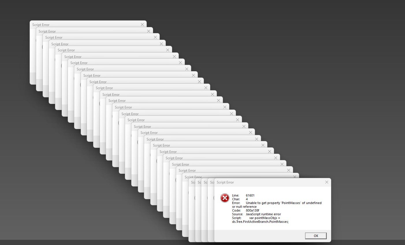

SubscriberI decided to go with Ansys Meshing and I think I found a good aproach how to mesh it. However I have some troubles with Workbench/Ansys Meshing. I get this error message and I cannot open any mesh at all in Workbench after a lot of work.
AnsysWBU.exe encountered a problem. A diagnostic file has been written: C:\ ............AnsysWBDumpFile.dmp
What could be the problem?
April 8, 2025 at 1:57 pm
Rob
Forum ModeratorAny mesh or just this project?Â
April 8, 2025 at 2:17 pm
Daniel.dejan.gunde
SubscriberIt was for any mesh in any project. It seems that I solved that problem. I had to remove the following folder: c:\users\appdata\roaming\Ansys.
However, a new old problem reapeared. It had happened before and because of it I started over with the current project in hope that it won't reapear but it did anyway. This time it is for any mesh in any project. I was looking for solutions before but couldn't find anything in this topic.
