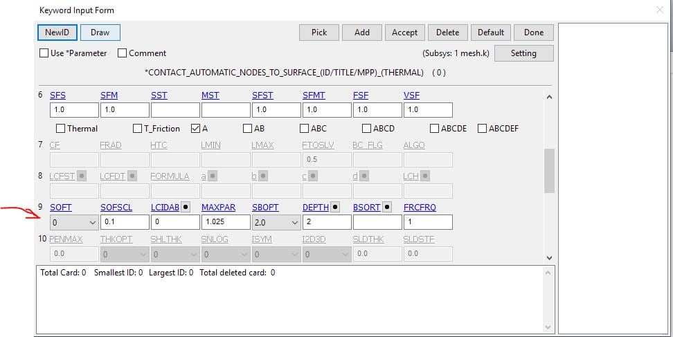

      May I ask you where to find these setups if you have a chance to answer. Thank you
      • Set contact controls back to default except set SOFT=1 and IGNORE=2 (Optional Card C).
      • For contact of sharp-edged surfaces, set SOFT=2 on Optional Card A.   SOFT=2 is also referred to as segment-based contact and so is not applicable to any NODE_TO_SURFACE type contacts.  Two important companion variables to SOFT=2 are SBOPT and DEPTH.Two important companion variables to SOFT=2 are SBOPT and DEPTH.
        SBOPT:  Unless sliding between surfaces is prevalent, set SBOPT=3.  When sliding is prevalent, set SBOPT=5.
        DEPTH:  DEPTH=13 or 23 is recommended unless shell edge-to-edge contact must be considered, in which
        case set DEPTH=25 or 35.
        Please note that SOFT=2 contact carries some additional expense as compared to SOFT=0 or 1,
        particularly using nondefault values of SBOPT or DEPTH.
    • Wenlong
      Yes, If you look at the .k file (the input file), or open the .k file in LS-Prepost, under the "*contact_...." keyword, you can see these options:

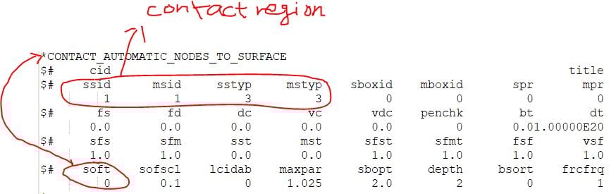

      Hi, this is a bit out of topic and sorry for being so stupid, but I have several soft in my input file and ignore only one. I have 4 bonded contacts (for other parts) and 1 frictionless contact for the dropped object. I do not understand link/dependence between of them. Would you please advise? Thank you.
    • Wenlong
      Hi, It is never stupid to ask a question. In the keyword file, each *contact card defines a contact pair, and the following soft keyword defines this *contact's behavior. Is this what you are asking about?

      Thank you Wenlong, Actually, the case is still open, because when I increased the end time, the energy plot started to look like this. It is still a miracle, why it happens. Thank you
    • user deleted
      Tusen takk!!
      See below with soft 1, finally good results!
