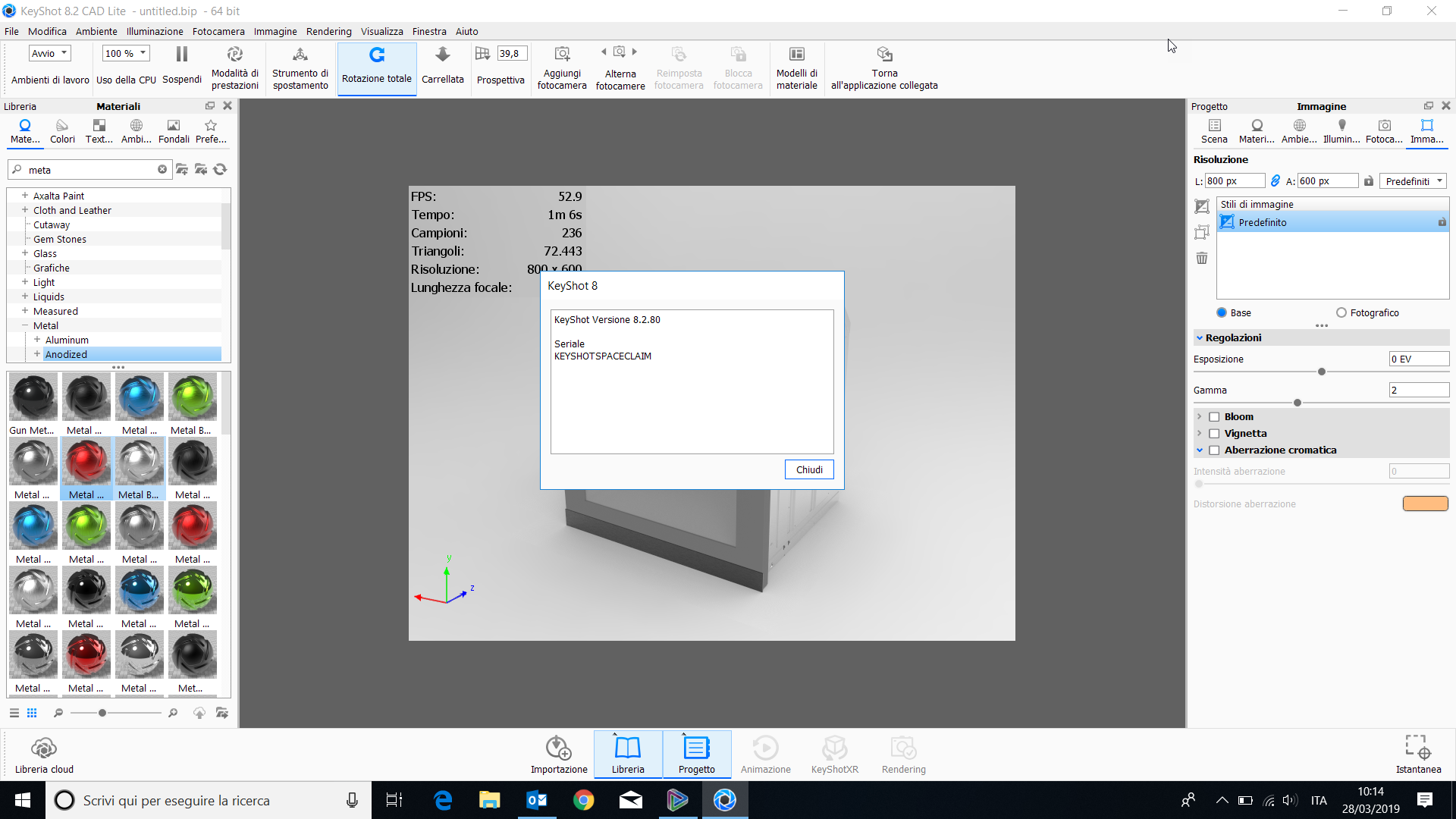

Ansys EmployeeHello Roberto

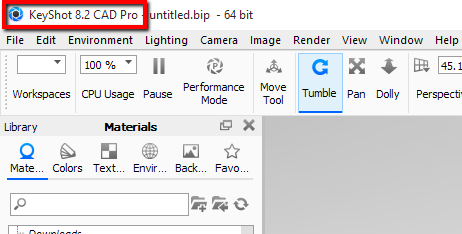

I think the reason is that the Keyshot version you have is "Keyshot 8.2 CAD Lite" which is a free version of Keyshot ("Lite"). You need to have a regular version of Keyshot ("Pro") with a license. I downloaded version 8.2 and it showed me Pro version. See below image. I am not sure how you are seeing the Lite version. I would request you to uninstall and download version 8.2 again from Keyshot website and try again.

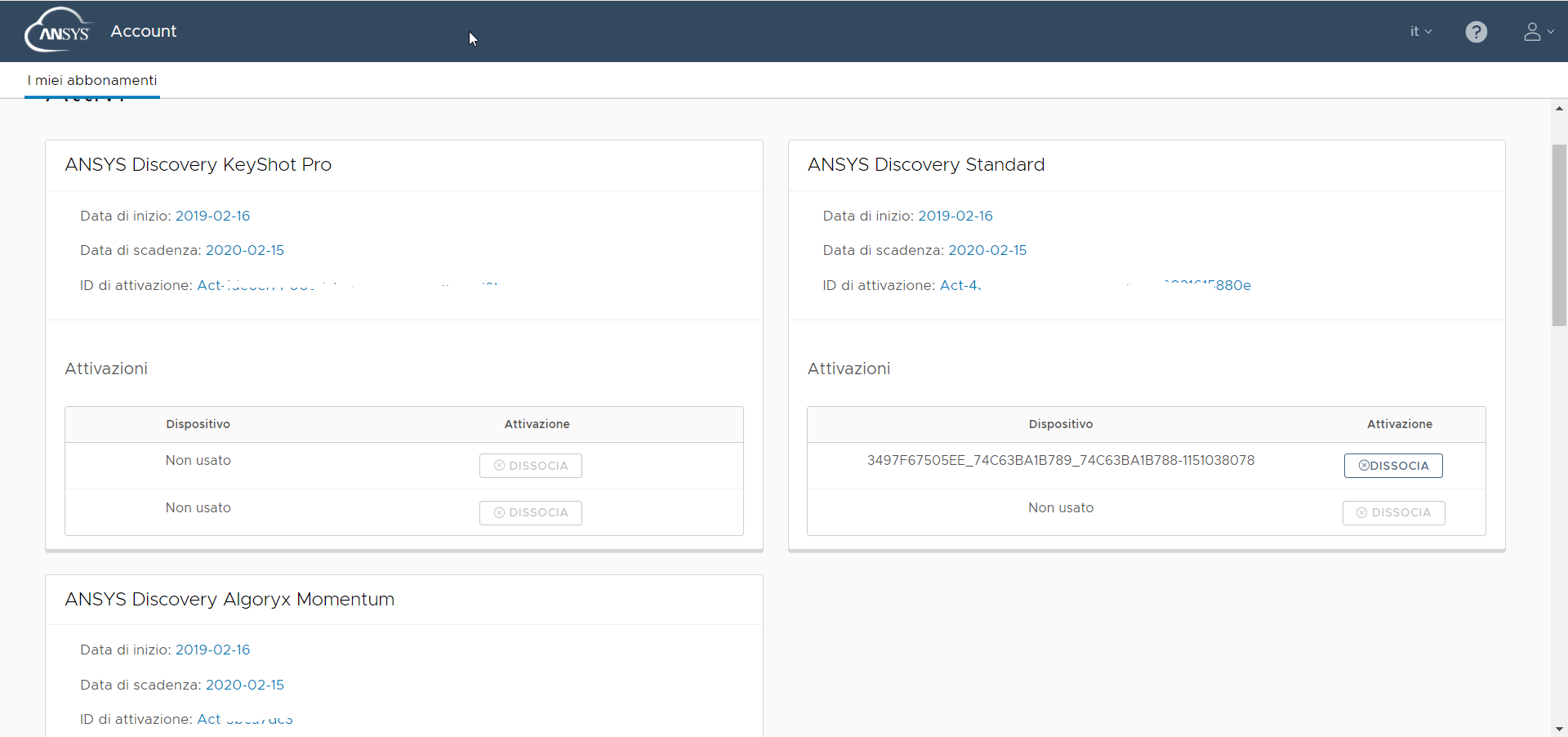

Hi, I solved it this way
1) Accessing the portal and dissociating all devices
2) Open SpaceClaim and now I read the license of keyshot correctlyÂ
