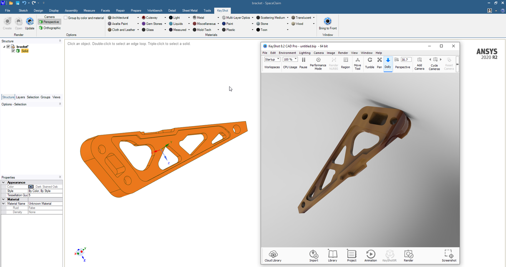

      I just tested a simple case and could send the model from SpaceClaim to Keyshot using the Keyshot addin. See below snapshot.
      Can you let me know which Keyshot version gets launched on your machine when you click the "Create" button in Keyshot menu? Also, which Keyshot license do you have?
      I don't think Keyshot version 9 is supported. The supported version is 8.2.
      The Keyshot add-on license that is available under Discovery/SpaceClaim license bundle doesn't allow the use of Keyshot in standalone mode. You can launch Keyshot only through the button available in the Keyshot menu of SpaceClaim.
