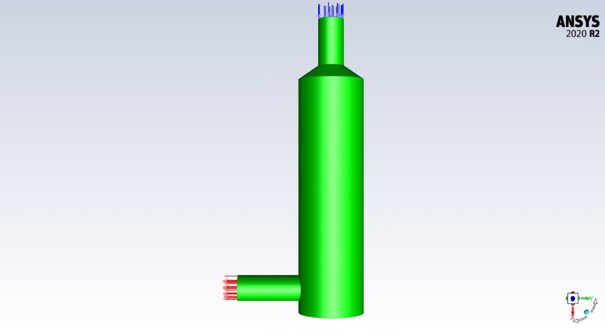

      I am trying to simulate water flow through a pipe with horizontal and vertical inlets. Basically, the water flows through the pipe and hits an end wall and eventually goes through the outlet. Choosing the right turbulence model has become a bit of a delimma for me since I get different results depending on which model I use. Based on what I have read, SST k-omega model seems to better fit internal flow and flows that deal with fluid-wall interaction. I would like to know the insight of the community that has more experience with these models. Is the SST k-omega the better choice in this case?
      I have also attached a photo of the geometry.
      Images of the results will help. Along with convergence plots.  I also suggest replying to answers when they're given: opening a second thread tends to annoy us more than it helps you get an answer.
      In terms of the models. I'd expect near enough the same result for SST and k-e if you use the enhanced wall treatment and converge both. This assumes the mesh is adequate.
