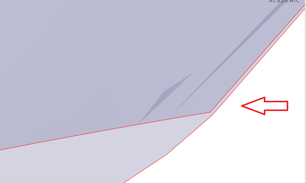

      Hi good afternoon!!!
      I have a question, how do I join several different surfaces on a single surface?
      Is there any tutorial to teach?
      Daniel
    • Sandeep Medikonda
      Hi Daniel,
       Yes, you can use the Merge Faces tool in SpaceClaim. Please see this section from the help.
        Not only this, you can also you the Stitch or Gap tool to work with faces.
      Sandeep
    • Ina
      Hi everyone,
      How can I join two surfaces with a gap in between?
      Thanks in advance
      Ina
      In SC, you can use the Pull tool to lengthen each surface. Then use the Up To button in the Pull command to trim one surface to the other surface.
      Or you can select the two edges and use the Blend tool to construct a surface to bridge the gap.
