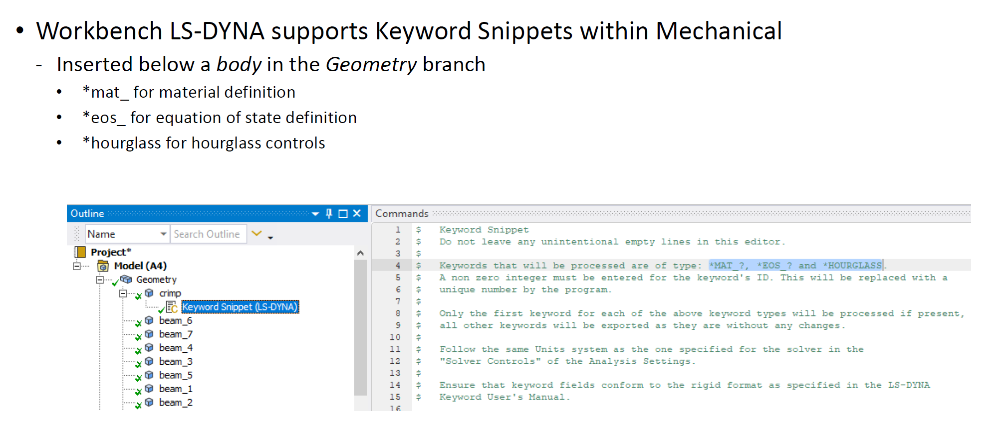

      I'm going to couple Jmat pro with Ansys.
      I'm going to use Jmat pro to capture the physical properties during metal additive manufacturing.
      I was wondering if any of you guys have done that.
      Please reply if you have any information.

      I am not familiar with JmatPro. I did a quick search and it seems there is an export to LS-DYNA from JmatPro. What is the material output? What is the LS-DYNA *MAT_ card written by JmatPro?
      Are you trying to do welding simulation? JmatPro has been used with LS-DYNA for welding:
      https://www.dynalook.com/conferences/16th-international-ls-dyna-conference/metal-forming-t8-2/t8-2-a-metal-forming-138.pdf
      If JmatPro exports the correct *MAT_ material card, then you can import this *MAT_ card in Ansys WB LS-DYNA (Mechanical) using a command snippet under the appropriate body:
      Let me know if this helps or not.

      "The export from  JMatPro® to LS-DYNA is for welding simulations and based on the CWM model. It was created after a request by an existing customer and is limited to Al alloys and steels.
      The next major version of JMatPro® will include an export to Ansys Workbench for all material types considered.
      It is always possible for the end-user to cut and paste the calculated properties from JMatPro® to whatever format required".
