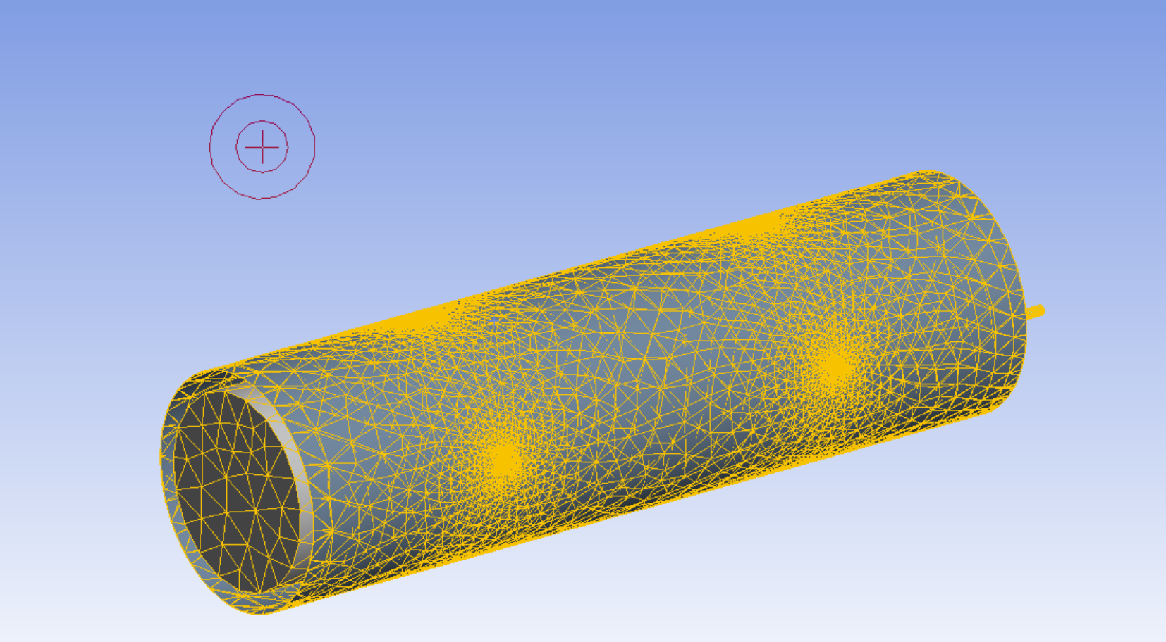

SubscriberWhat are the impacts of not using a shared topology?Cannot mesh after sharing topology.
after sharing topology :
no sharing topology:
I have also tried using ICEM to partition the mesh of the gas film, but importing the model resulted in surface loss and fixing it did not work. Thank you for reading:)
April 18, 2025 at 7:39 am
2627971244
Subscriberhow to mesh if i use Shared Topology?help me pls.
April 19, 2025 at 1:46 am
kuumbara
SubscriberI suggest you to use "Imprint" method of sharing topology (check on DesignModeler) so that when you open "Meshing" system, the system will generate "Contact Regions".-
April 22, 2025 at 2:21 am
2627971244
Subscriberthanks my friend,i will have a try
