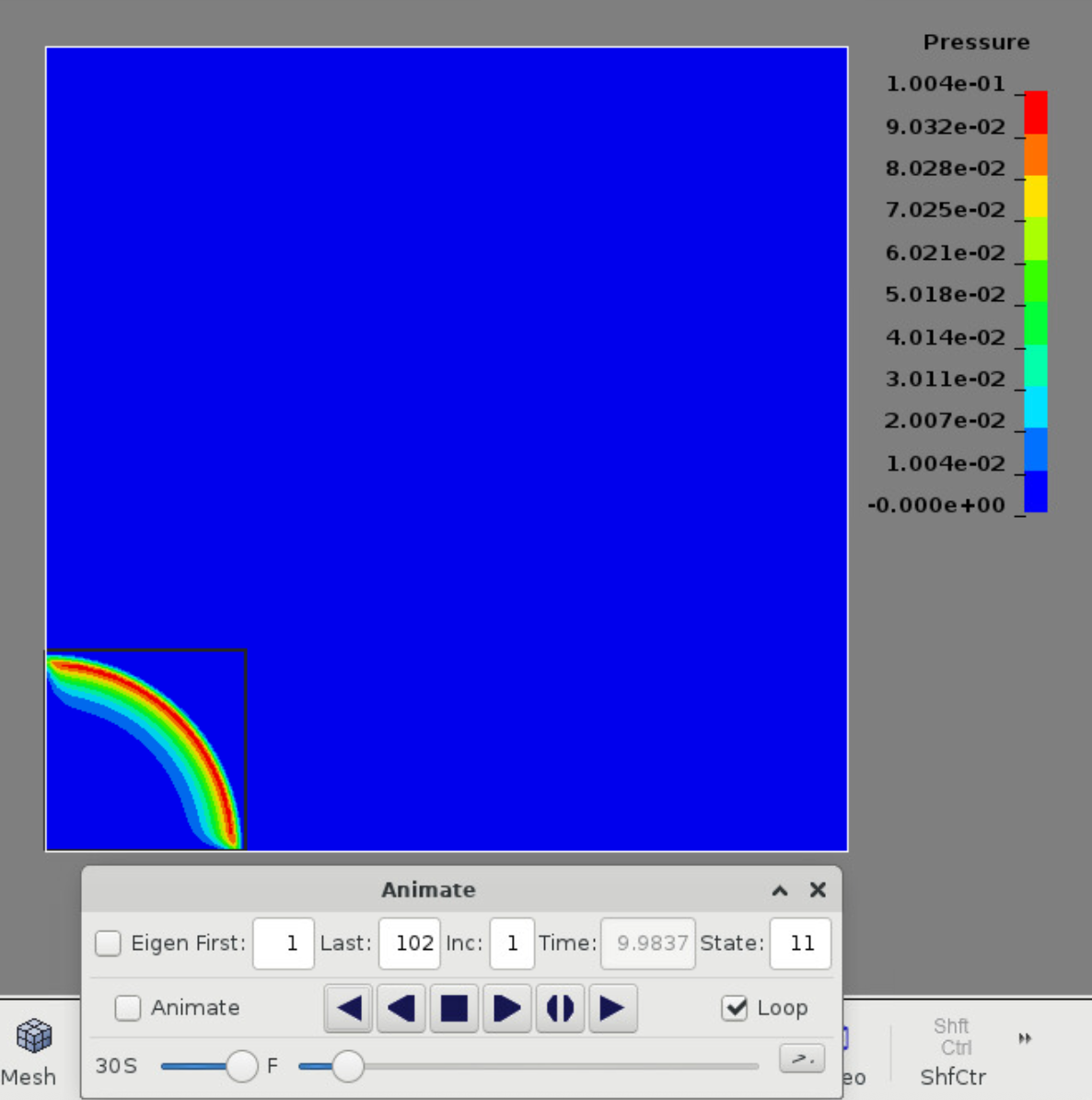

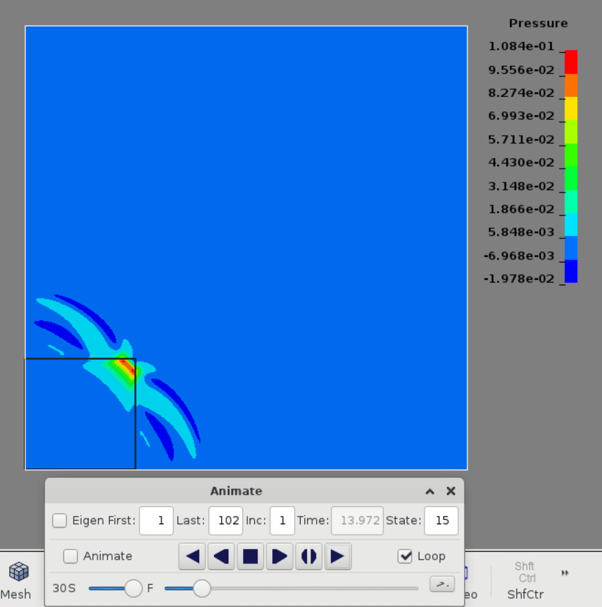

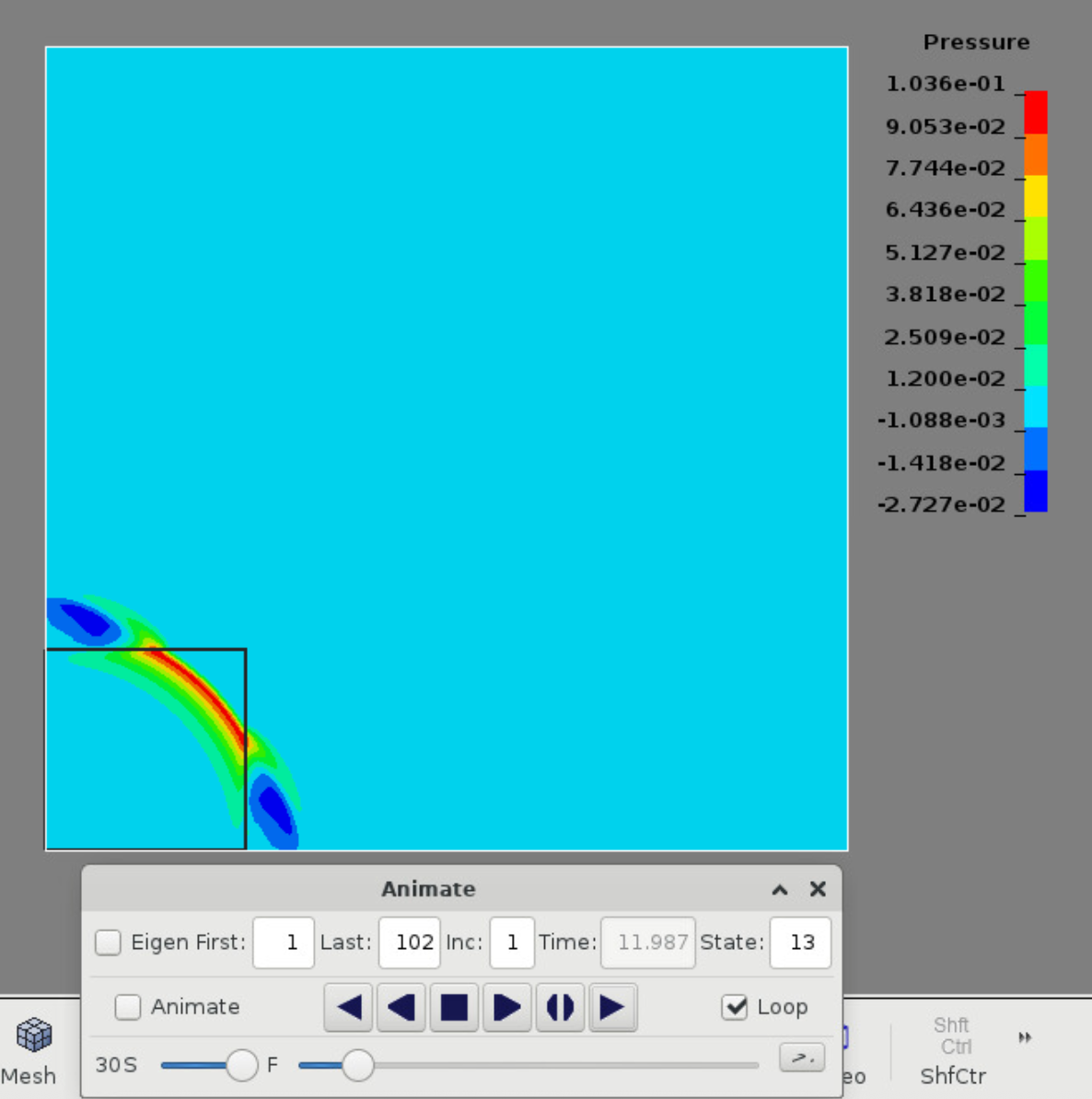

SubscriberHello, I would greatly appreciate some help with this. I am modifying an official LS-DYNA example, Underwater F (https://lsdyna.ansys.com/underwater-f/), to instead have a square field that is constructed with an S-ALE mesh. Everything else stays the same, so the resulting simulations should look identical for the first ~30 time steps, until the shock wave reaches the boundary of the cutout in the example. However, they look different and the shock wave is not propagating outward into the water and it looks like there is a boundary effect.
I created an S-ALE mesh and a box region at the bottom left corner (the origin). I filled the entire region with water and then the box region with the explosive material. I detonated the material at the origin at time 0.
1. There seems to be some kind of boundary effect at the box region. I don’t think I defined any boundaries and am wondering if there is a discontinuity or something between the two materials. However, I don’t know how to fix this, particularly with this S-ALE method.
2. Originally, I kept the element sizes the same, 1 element = 1 cm. However, for my simulation, the velocity contour did not show the shock wave, which was very strange, so I refined the mesh to have each element be 0.16 cm. Now I can see the shock wave, but it is strange that this refinement was not necessary for the official example but was for mine. Would anyone know why this might be?
Please, I would greatly appreciate some help, thank you very much in advance.
Here is my code:Â
