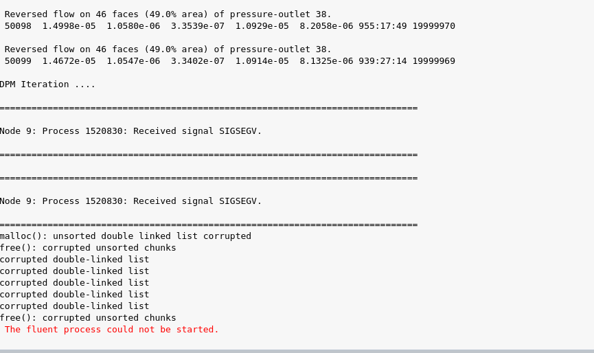

Subscriberthis UDF code is for computing the melting index along a particle trajectory.
this code has been tested in 2d and 3d cases in the DPM model.
what I tried to achieve is by using this code to obtain the particle locations of 10 particles with respect to time.
based on my understanding, this code just records ONE particle location and writes them into a file (melting_output).
I copied the code and pasted it into txt file. I hooked it up in DPM model.
the code could be compiled but when DPM iterates, then I this SIGSEGV error.
I used a linux server to run fluent case.
I searched it; it is said this error showsÂ
"SIGSEV tends to be network related, but may be triggered by something else in the solver: it's not an error we can diagnose as such. What did the TUI show just above all of that lot? That text may be more useful." from Rob.
the model works before using this code.
how to debug this kind of error?

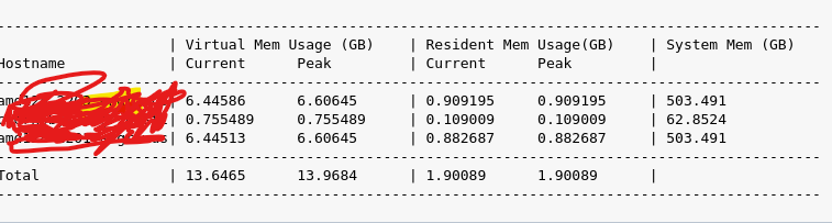

Forum ModeratorI assume you have set a scalar up to store the data?Â
However, "malloc" is Memory allocation so check the amount of RAM you have available.Â

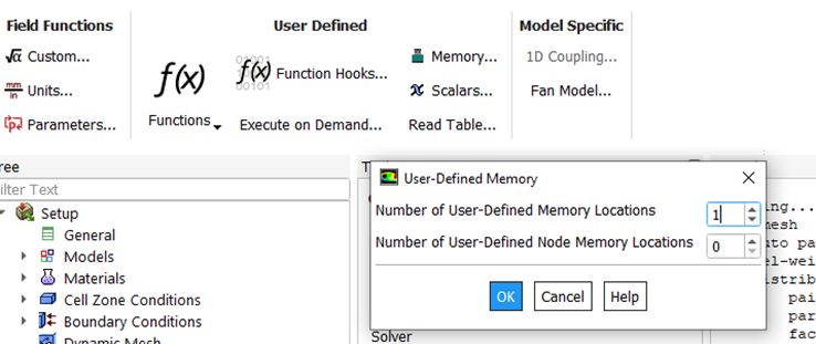

Forum ModeratorYes, you need to set the UDM memory allocations or things go wrong - I thought you were using a Scalar though?Â
