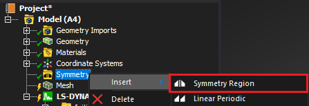

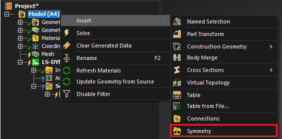

Have you applied the appropriate symmetry boundary conditions to accurately represent the response of the full model? If youβre using Workbench LS-DYNA to set up the model, you can apply symmetry boundary conditions by right-clicking on the Model branch and inserting βSymmetry.β
Next, insert a Symmetry Region as shown in the screenshot below, and choose the symmetry plane and symmetry normal. -
