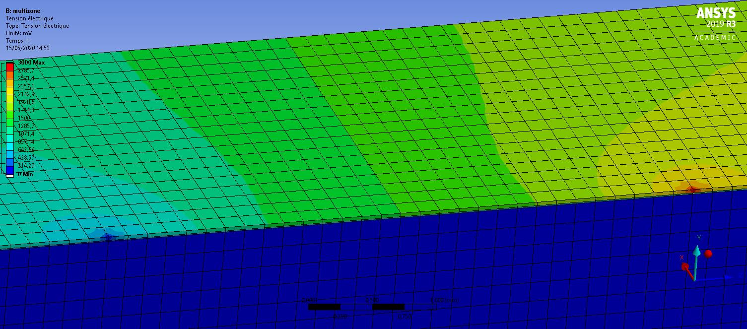

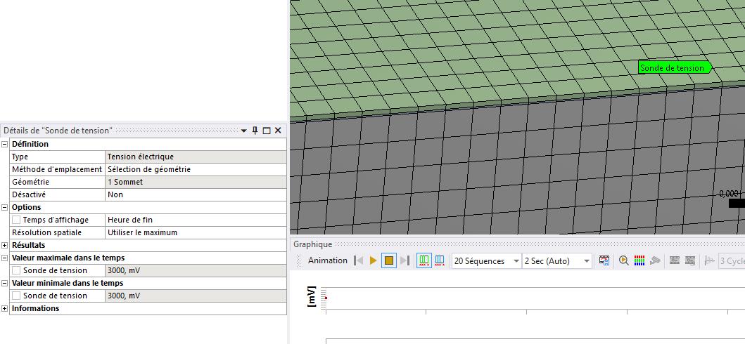

      I managed to get some results but when I visualise them, I get different results whether I use the global visualisation tool (color shades) or the probe tool.
      I joined pictures of my issues : when I visualise the voltage in my piece with the global tool, I get around 1500 mV with a very slight gradient, but when I use probes in the same spots, I get 3000 mV regardless of the spot on the piece.
      What do you think might cause that ?

      On the top image, I can see a red hotspot of 3000 mV which image is showing 1500 mv? (Bottom image is bit unclear to me, specifically what it is scoped to, due to different language)
      Results are fetched from the same results file so they should not be any different ideally.

    • solmyr999
      In the green areas I get around 1500 mV but when I use probes in the same areas, I get 3000 mV.

      Sorry still not clear to me how are you probing only green area? It seems continuous to me.
    • solmyr999
      The green area does have a slight gradient (slight shade of green). The problem is that I get 1500 mV from the color image and 3000 mV from the probes in the same places ...
