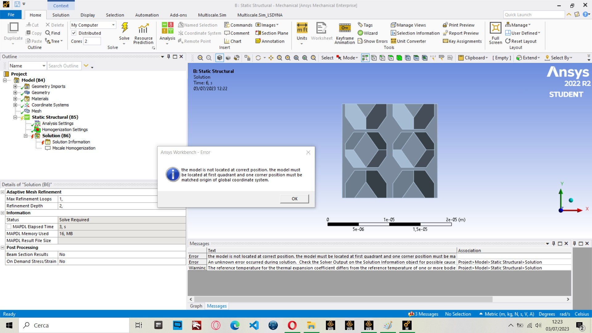

      Hello everyone,
      i created this structure in APDL. So, now i would like doing a homogeneization.
      I have this problem with geometry, but i don't know how to solve this issue.
      Someone can say me how to fix this problem? Thx for helping
    • Aniket
      Have you checked if the origin lies on one of the corner of the lattice and the lattice is first quadrant of the global coordinate system as indicated in the error?
      Can you select and post an image with global coordinate system?
      -Aniket
    • Michele De Giosa
      Hi Aniket,
      sorry for the delay, but I had to study before solving the problem, which was successful with one type of geometry, but not with the other! So I think I will have to change the geometry type to match the edge and angle, with the vertex of the coordinate system.
      Thank for support
