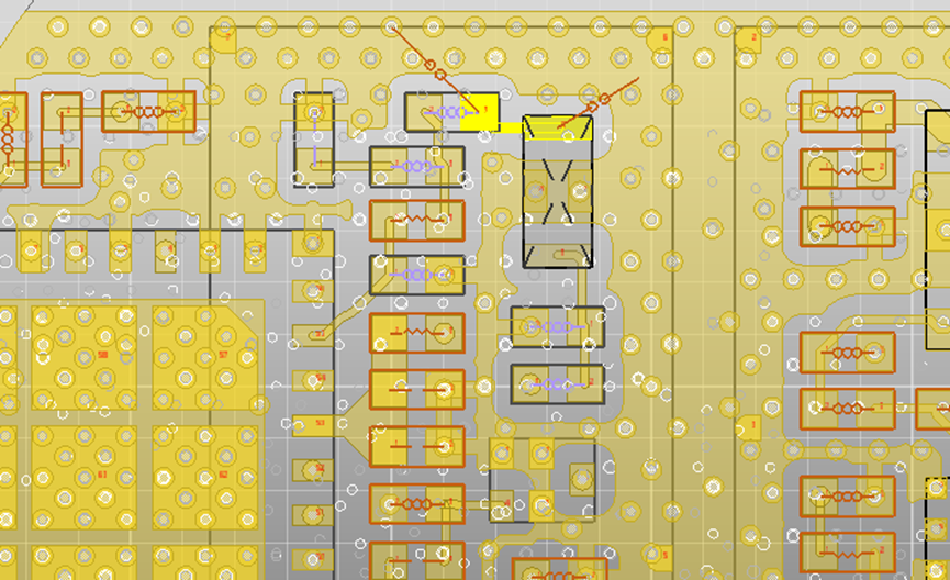

I’m having an issue while simulating with Siwave.
Let me first provide some background:

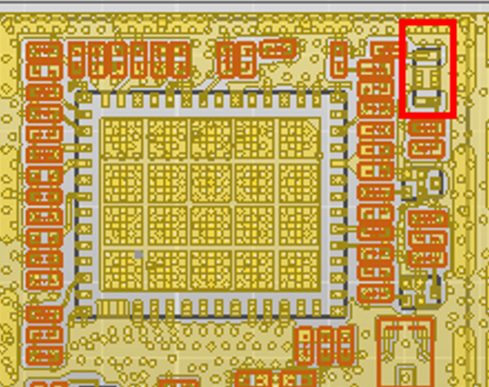

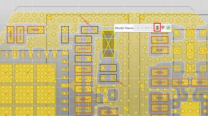

This is what our OBD++ looks like when opened in Siwave; the component in the red box is a TDK low-pass filter.I have the S2P file for this LPF, and I simulated it in ADS. This LPF has excellent insertion loss.
I now want to import this S2P file into Siwave and disable all the capacitors and inductors connected to this device, adding a port at each end.

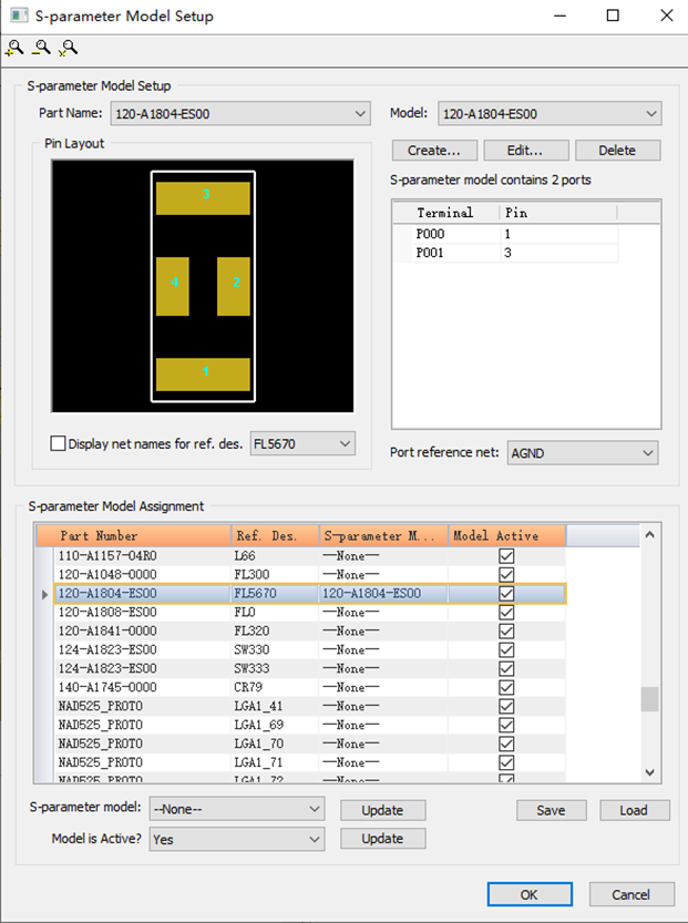

Here are the steps I follow to import S2P file.

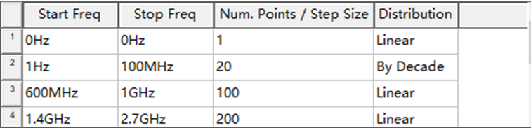

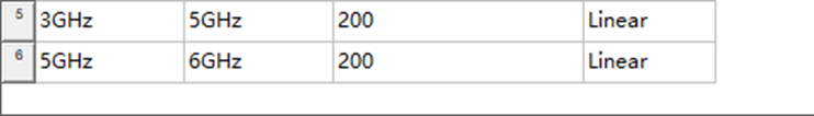

Next, I set the frequency range for the simulation.

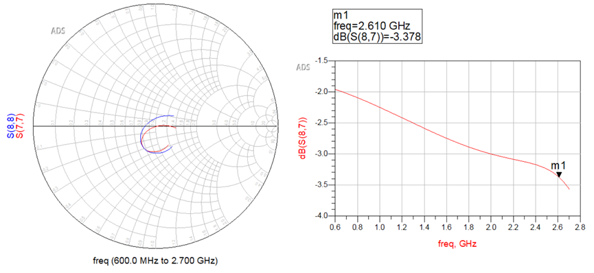

After simulation, an S2P file was generated, which was opened in ADS.
The insertion loss is surprisingly high.

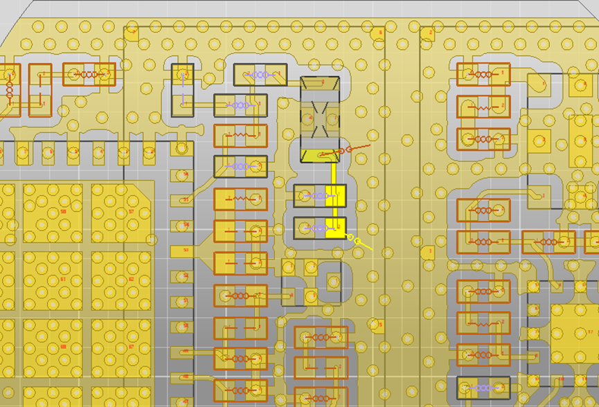

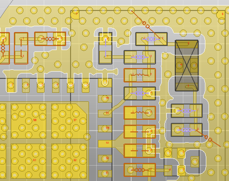

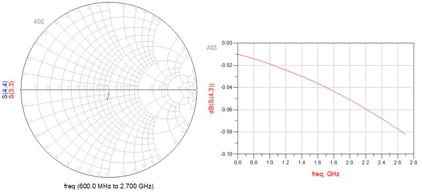

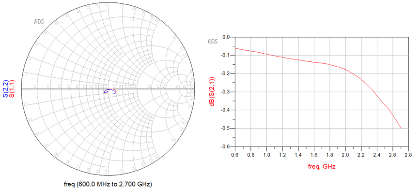

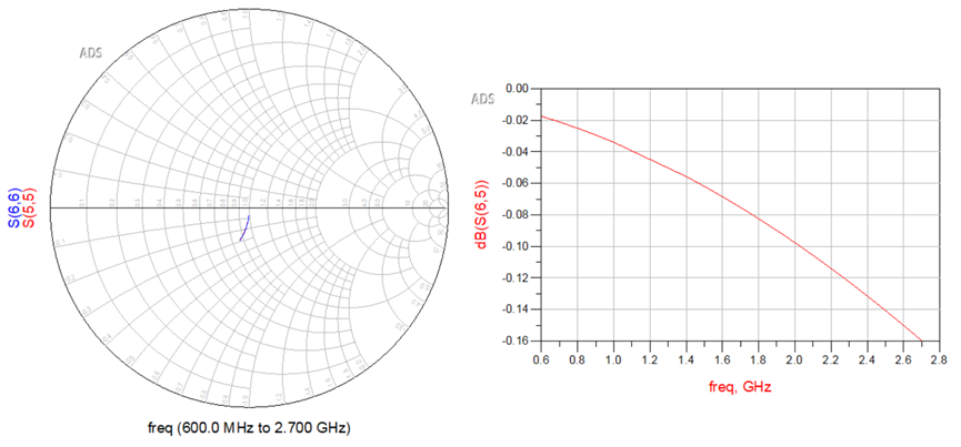

Next, I wondered if there might be a problem with the traces at either end, so I simulated each trace separately and checked the results in ADS.
Trace 01
Trace 02
Based on the simulation results, there are no issues with these two traces.
