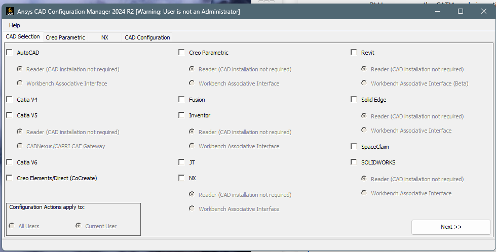

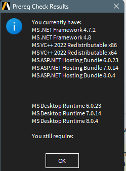

      However, I've been trying to solve this since yesterday, but I still haven't managed to make it work. I've even come across people who somehow succeeded in importing this as early as 2013.
      Here’s what I’ve tried so far:

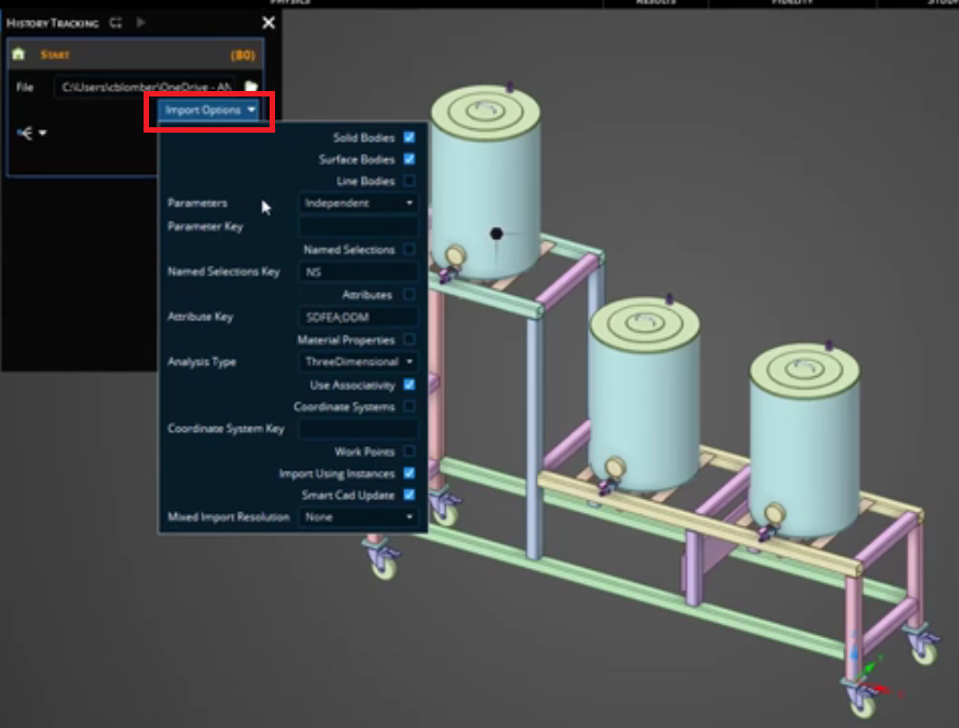

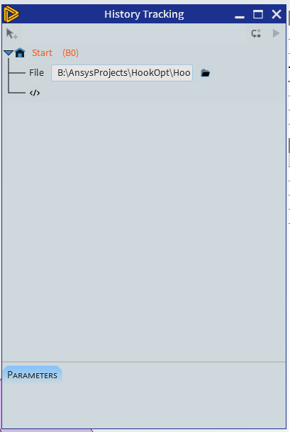

      I attempted to open the file with Ansys Discovery. However, the import section shown in Ansys' official tutorial videos does not appear on my ansys, as you can see in the attached image.
      At Ansys Official Video, there is an option as Import Options, which does not appear for me.

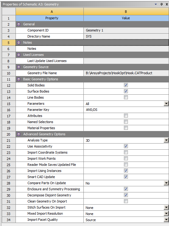

      I also tried loading the geometry directly as a product in Workbench. Even though I selected the parameters in the properties section (and saved all my geometry parameters with the prefix of DS in CATIA), the model still doesn't show any parameter options for the geometry no matter how many times I refresh it.
      If you are able to help, I would be truly grateful. It would solve a major problem for me.
