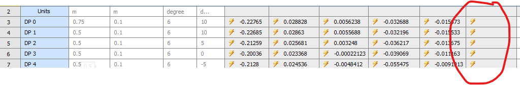

SubscriberI made a mistake in the definition of an output parameter, and realized it after a few (20) design point analyses. When I corrected the definition in the setup, the data from that column disappeared and others are preserved even though with the âš¡ symbol. Is it possible to calculate the value of the missing paameter only for the design points, or will I have to run the analysis again? I have them exported into individual projects but that would be too cumbersome.Â

Forum ModeratorYou can't just update one parameter as the table is created from the runs, not data-mined. Assuming the case & data still exist you could manually extract the value(s).Â

Subscriber"Assuming the case & data still exist you could manually extract the value(s). "
Could you tell me how to do this? The second last column and the one before are moments about x and y axes, and the third was supposed to z where I mistakenly put x again.

Forum ModeratorSet each DP in turn as "active", right click on the blue column cells then (I think) you can open the Solver part of Fluent from the workflow. Otherwise you need to go into the Workbench folder and find the various Fluent files in the dp# folders.Â
