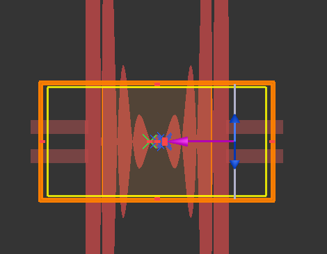

      Hi all,
      I tried to optimize a polymer y-branch according to the example here (https://optics.ansys.com/hc/en-us/articles/360042305274).
      Since polymer (SU-8) has a much lower refractive index, the main different is the size. I modified all sizes in the base setup .py file and the simulation .py file, yet error occured saying "The initial X is infeasible.  Restart with its projection." As a result, the polygon structure extends beyond the bounds defined, and FoM could not be calculated.
      Attached please find the screenshot and codes. Please help to check if I made anything wrong.
      Thank you very much!
      [File 1]

    • Guilin Sun
      I just found your post which is in the wrong forum. Lumerical has dedicated English, Chinese and Korean forums:
      /forum/forums/forum/discuss-simulation/photonics/
      /forum/forums/forum/discuss-simulation/photonics/photonics-chinese/
      /forum/forums/forum/discuss-simulation/photonics/photonics-korean/
      Next time please post in the proper forum in order to get quick reply.
      You may find more resources online  https://github.com/chriskeraly/BerkeleyPhotonicInverseDesign
      I would recommend that you modify the structure gradually one by one from small changes.  Before you are skillful, please follow the examples, do minor change and see what happens.
      Please write new post in the correct forum if you have questions.
  • The topic ‘Inverse design of polymer y-branch – modify the example provided’ is closed to new replies.
