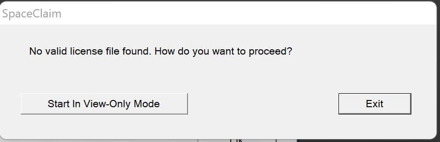

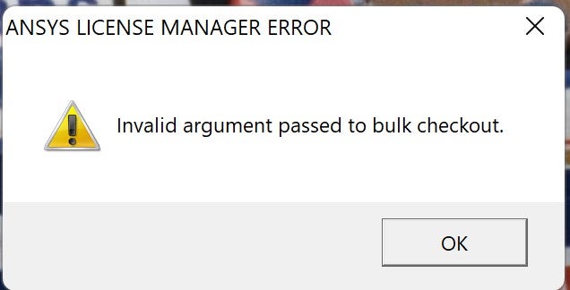

      I just installed Ansys student 2021R2 and I'm unable to use SpaceClaim. I can open a project in Workbench just fine but when I try to open SpaceClaim (either through the project or just standalone) I get this error message, followed by a message telling me that no valid license was found. However, the license should be built-in and valid until 01/31/2023. How can I get SpaceClaim to work?

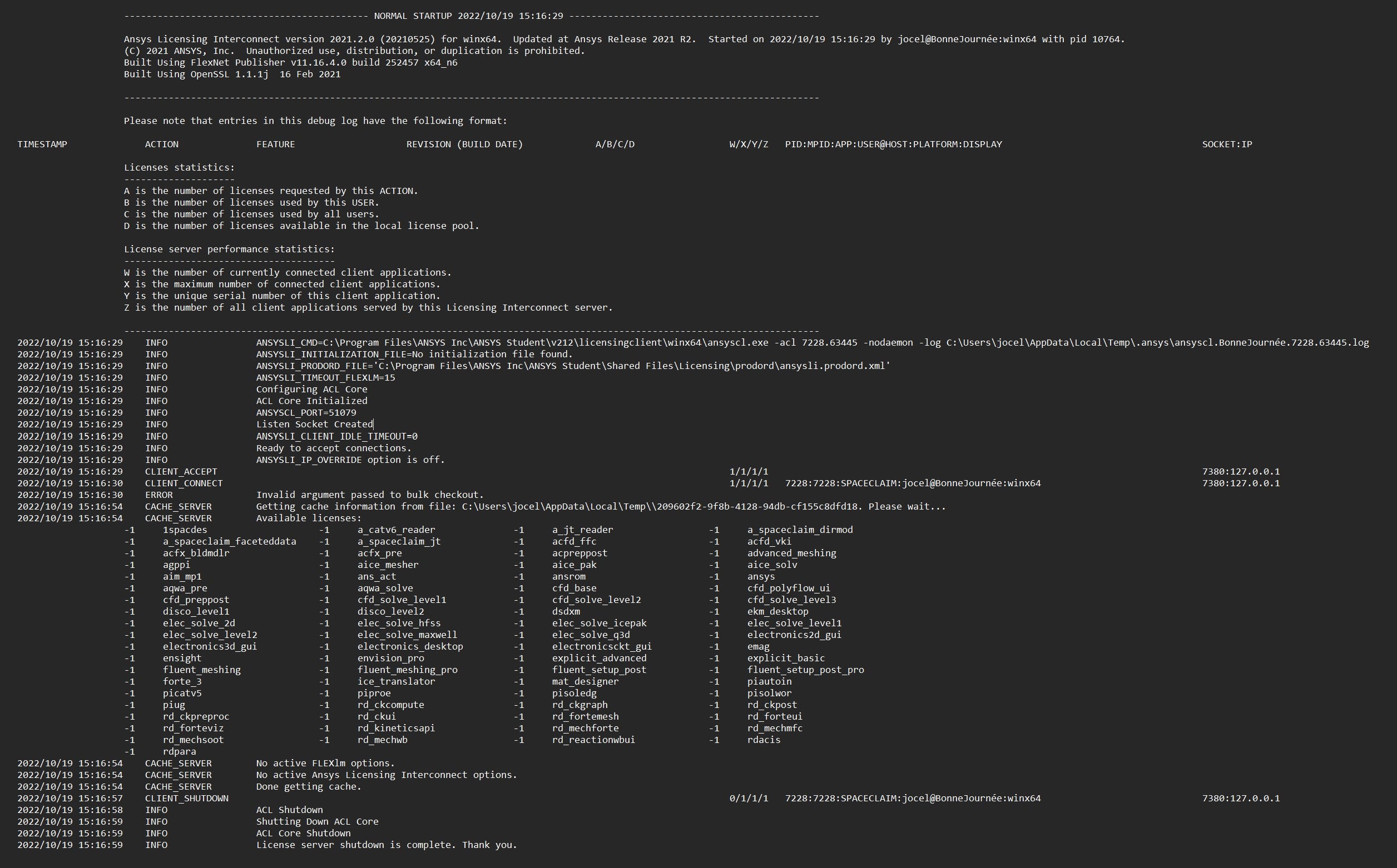

      Under %TEMP%\.ansys you should see license debug files.
      Are there any errors listed in the debug files?
      • Jocelyn Dubuc
        Here is what I see in the license debug file when I try to open SpaceClaim. Please let me know if this isn't what you're talking about.
        • Jocelyn Dubuc
          When I open licdebug.SPACECLAIM.212.out, this is what I see for my most recent start-up of SpaceClaim:
          2022/10/19 15:16:28    INFO                Starting Licensing Client Proxy server.
          2022/10/19 15:16:28    INFO                C:\Program Files\ANSYS Inc\ANSYS Student\v212\licensingclient\winx64\ansyscl.exe -acl 7228.63445 -nodaemon -log C:\Users\jocel\AppData\Local\Temp\.ansys\ansyscl.BonneJournée.7228.63445.log
          2022/10/19 15:16:28    INFO                Started ANSYSLI server.
          2022/10/19 15:16:30    CLIENT_CONNECT                                                                                           1/1/1/1   7228:SPACECLAIM:jocel@BonneJournée:winx64                  7380:10.192.177.151
          2022/10/19 15:16:30    NEW_CONNECTION      Connected to Licensing Client Proxy server: 51079@127.0.0.1.
