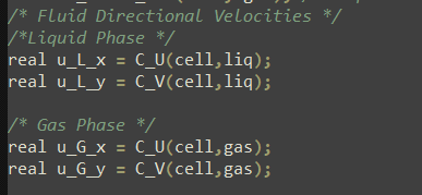

Ansys EmployeeHi,
I think you are correct, the phase velocities at the cell centroid represent the intrinsic volume averaged velocity of that phase over that particular cell.
