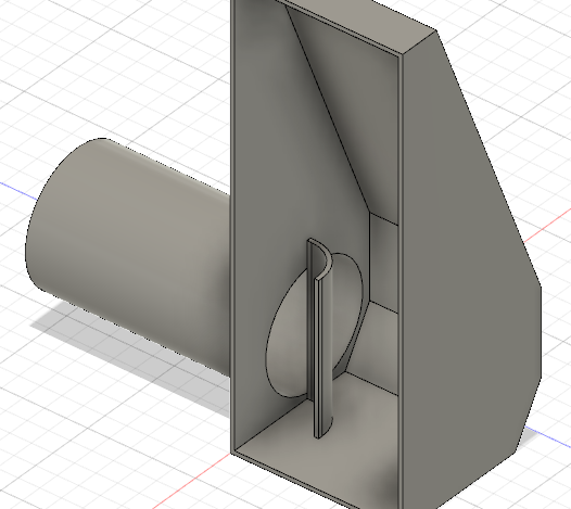

      I'm trying to simulate an internal flow of intercooler end tanks. I want to design them as best as possible while keeping it simple because of welding.
      I want to see how air travels from inlet ( the opening for a tube) towards the end cap.
      This is my model.

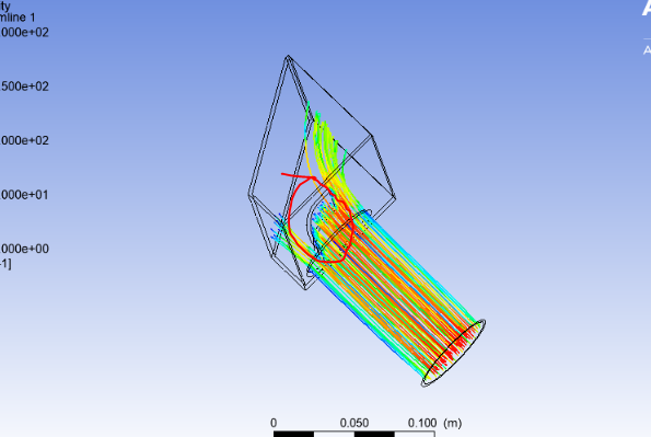

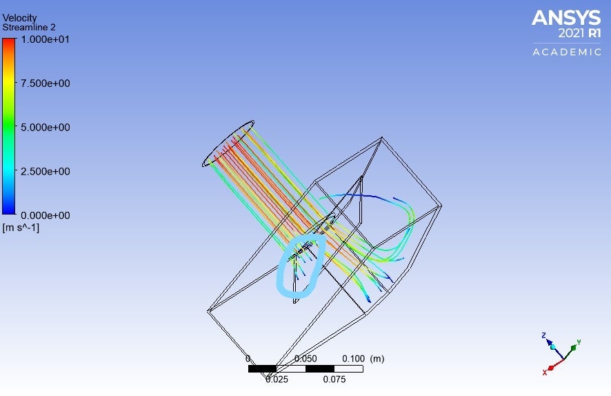

      Do you maybe know why the stream-lines aren't projecting after my dispersion fin/ plate, like other lines ?
      Is there a way to extend the stream lines to see how the "move"

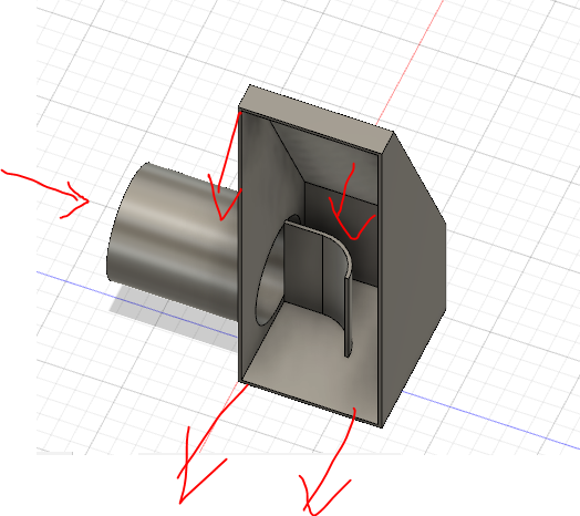

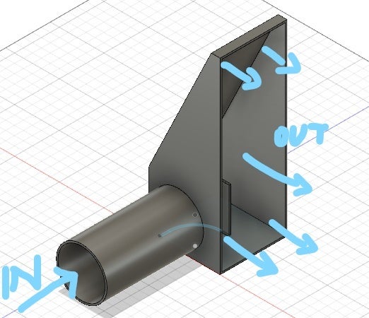

      Streamlines shouldn't pass through the plate (assuming it's solid). Where's the outlet?
    • AmerM97

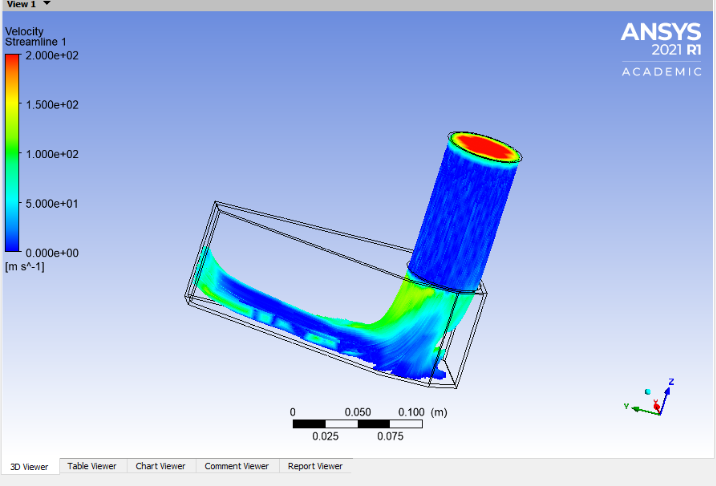

      Well they aren't passing thru it, but when they "hit it" they just stop.
      Shouldn't the streamlines that hit the curved plate follow the shape of the curve and deflect to the right, and not just stop. I can't figure this out, so I could configure shape of the fin the optimal flow efficiency. Because my most successful model has this.
      Has 1/2 of the tank un-used - no streamlines.
      Does number of points = more realistic representation of air travelling ( represented via streamlines)
      Thank you for your replies.

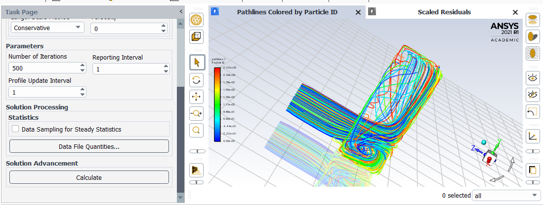

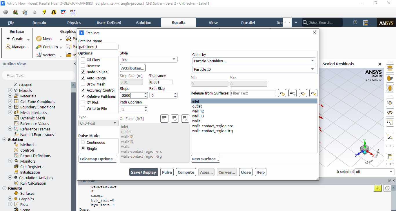

      Are you using pathlines or massless particles? Also check the max steps in the pathline panel. Note, pathlines follow the flow, if you have dead zones you won't see many pathlines.
    • AmerM97
      Well I'm almost leaving everything to default.
      I import the model-> Do volume extract in Space claim
      Mesh- Select create new named selections for inlet, outlet, and walls - Generate mesh
      Setup- Models ( energy equation - ON), Boundary conditions - Inlet - Magnitude velocity ( I have played with numbers 1-200 m/s - i get similar results)
      Run calculation- Number of iterations- 100 - Calculate
      Results-Add Streamline- Start from: inlet ; # of points : 1000
      I'm not sure where you select pathlines or massless particles?
      All other settings I left to default

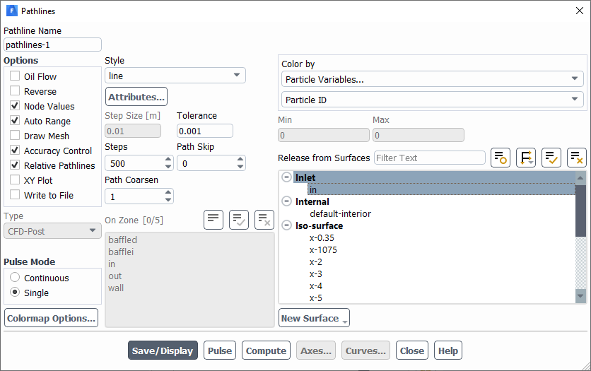

      Pathlines are in the Results section, and there's a value for max steps: increase that. You'll likely need more than 100 iterations, and if the results are similar for 1-200m/s something is very wrong with your model!
      Not sure where you get 1000 points from, increase the number of steps, 2500 is probably enough but check for their fates in the TUI as all should be escape with few/none as incomplete.

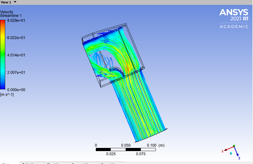

      iteration 500
      monitors 1e-6
      mesh 5mm and its not again again being deflected by the fin
      When I generate the faces for "walls" i click select all, hold CTRL and click on Inlet and outlet(to deselect them) to generate "walls" boundary
      Why have you got a non-conformal interface in the model? Delete the contact region in Meshing as I think the tolerance has picked up the baffle: you may be able to delete the non-conformal in Fluent then set the interface surfaces to wall. The clue is in the surface labels in the first image of your last post.
    • AmerM97
      Thank you now it's working after I deleted one of the wall boundary conditions, and change the way I create inlet and outlet. Very powerful software and easy to use, amazing.
      I really appreciate the time you took to read, and reply to me. This is going to be so much helpful, thank you!
      Thank you ANSYS for making this available !
      You're welcome, glad to hear it's working. The automatic interface tool is very useful at times, but less useful with baffles and aerofoils as it can pick up the two faces due to the tolerancing.
      As an aside, we usually model baffles as a thin wall as it negates the need to resolve the thin faces surrounding them.
