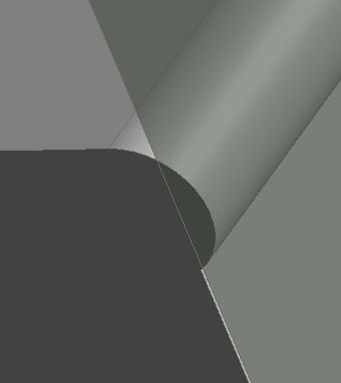

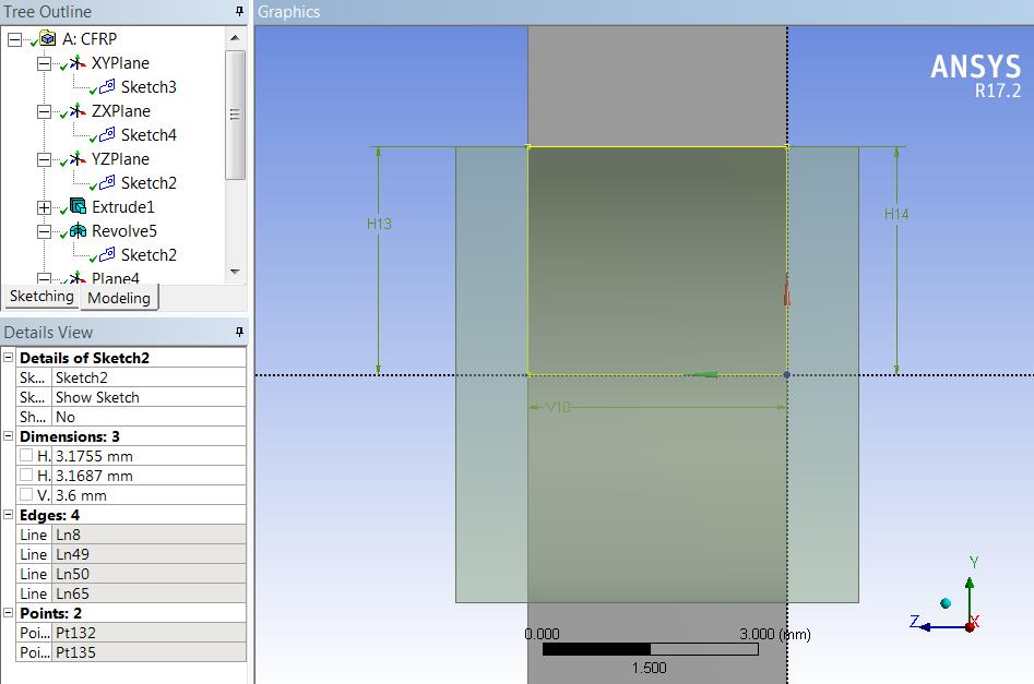

I did the step mentioned above, and noticed a very small round protruding from the hole. Was this supposed to be removing material on the edge to make a blend, rather than a protrusion? Either way, it is a mistake to include such a small feature when calculating bearing stiffness.

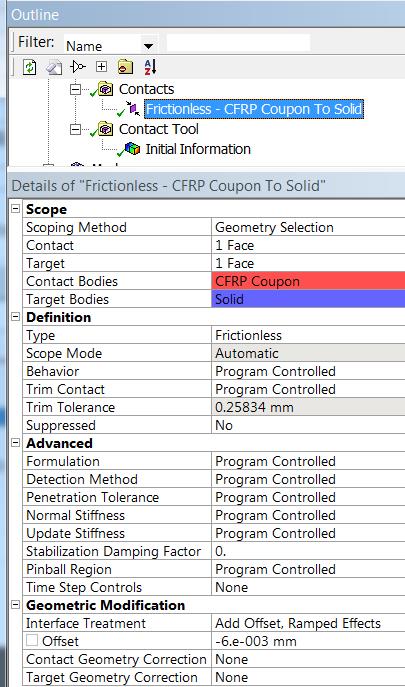

When you say "the hole in the coupon is 6.35102 mm on the pin side and 6.3373 mm at the other side" you mean that the hole has a taper. I edited your Sketch 2 that makes the hole to have those two radial dimensions. Now there is clearance on one side and interference on the other side.
I also suggest you make the two sides of the pin the Fixed Support, and apply a Force to the -Y face of the coupon.

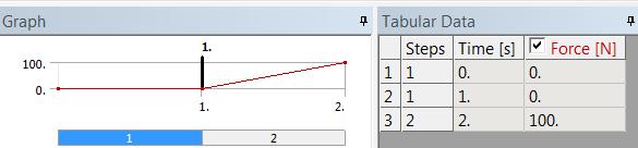

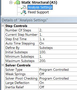

Under Analysis Settings, here is the two step settings for step 1. Note that Auto Time Stepping is On and Initial Substeps is 100.
The Force is zero in step 1 then 100 N in step 2.

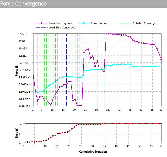

The first time I tried to solve this, the solver had difficulty. IÂ edited the contact in the Geometry Modification to offset the contact surface by -0.006 mm, which is most of the 0.00635 of the interference, and ramp the -0.006 to zero in substeps.Â
That was not sufficient. I added a displacement BC to the Y face of the coupon and set displacement to Free, Free, 0 to make sure that the coupon would not slide off the pin, since this is a frictionless contact. Adding friction is another way to prevent this problem.
When it nearly passed step 2, I added the APDL command neqit,50 so that it would not give up after 26 tries.

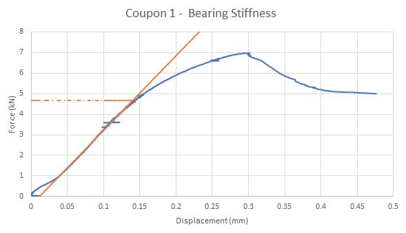

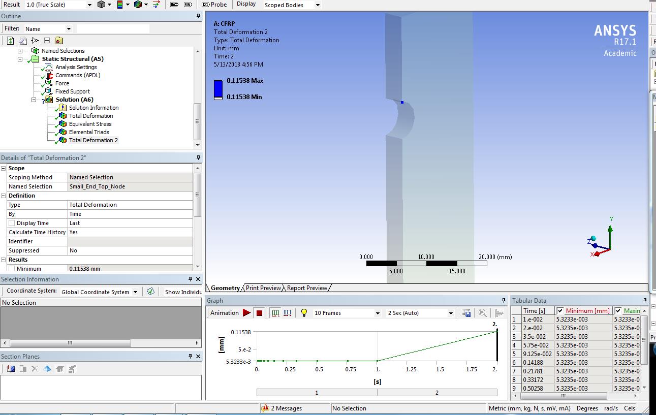

I set up the boundary conditions so that a 4 kN force pulls on the edges of the pin in the +Y and the bottom face of the coupon was set as a fixed support. I worked through your steps above up to the "Analysis Settings" step. After that, I managed to run a quick solution using a very coarse/raw/simple mesh. The deformation solution is very much inline with the experimental results (which can be seen below). Experimental results show that 4 kN of tensile force applied translate to approximately 0.11 mm of displacement, which is almost exactly the result of the simulation. I'm going to try to refine the mesh by following your instructions in an older thread and then attempt to run the solution again.Â
What do you recommend to improve upon this? Is my process sound in your opinion?
Experimental results:
Simple unrefined mesh:
"Top of hole" Displacement with 4 kN force applied:

SubscriberThis looks promising, but did you multiply the force on the half model by 2 to represent the force on the full model?Â
Yes, you need many elements through the thickness. You can fit 12 elements and stay under the Student license limits.

So pulling the half model at 1.5 kN yields 0.04929 mm, which means the full model is pulled at 3 kN to achieve the same displacement. This yields a numerical result of 60.9 kN/mm versus the experimental result of 36.2 kN/mm.Â
What in your experience/opinion might be causing this? Incorrect material properties possibly?

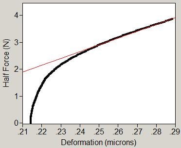

SubscriberI ran the model with very small values of force to look at the initial stretching of the hole. Due to the interference fit, the hole is pressing on the pin all the way around. It takes a little force to separate the hole from the pin on the tension side of the pin.Â
The plot below shows how the system acts like there is a preload and the force has to ramp up before it enters a linear range. The slope of the red line is 25 N/micron for the half model so the stiffness of a full model would be 50 N/micron or 50 kN/mm. At much higher values of force, the slope may change again. See above for reasons why this could be so different from experimental results.
The plot starts with an initial deformation because the face at the end of the coupon moves slightly when the interference is resolved.
