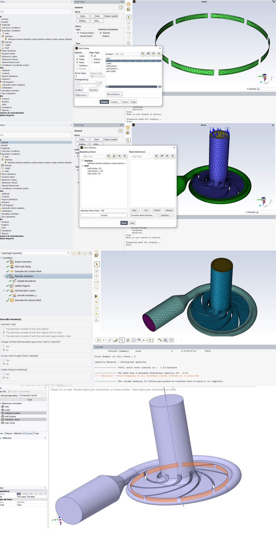

I am currently trying to design a centrifugal pump and want to simulation it in fluent and i need help with a problem on which i try everything for 3 days before comming here.
I have prepared my CAD (solidworks), imported it in space claim (volume extract and corrected geometric problems with it), have done my meshing in fluent but when i switch to solution i can't create a surface mesh since only 1 of the 2 interfaces is here (see pictures to understand, looks 'fusionned'). My two NS interface turbine and interface volute disapeared but this weird interfaces is now here. However, i can't creat a mesh interface with it which is annoying. (also, when shown, it isn't yellow as an interface should be but green).
I do not know how to solve this problem, i have tried to modify my CAD, use share in Spaceclaim, use share topology in fluent to 'force' the creation of an interface between the 2 parts i need, change meshing parameters and naming my surfaces many different ways, but nothing change.
In the attached files, you'll find 'stacked pictures' with :
- pics of the Spaceclaim model with NS ans the surfaces i want as an interface
- pics of the fluent meshing with everything done to it
- pics of fluent solutions highlighting the problem

October 17, 2023 at 2:20 pm
Federico
Ansys EmployeeSharing topology between the 2 interfaces will combine both as a single interface.Â
You can try TUI command in boundary/slit-boundary-face to slit this interface into 2 faces in Fluent, and then create a mesh interface.

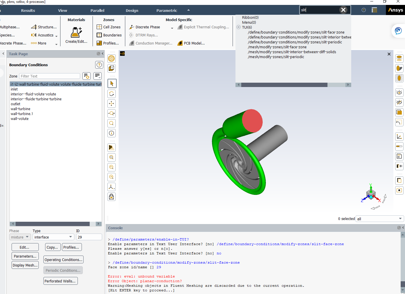

Unfortunately, i couldnt find the exact command you were talking about since i'm very new to fluent.Â
I tried to find it in the search bar and found something relatively close which I tried and it show the error that you can see in the picture.
Do you have any piece of guidance for me please ?
October 18, 2023 at 7:20 pm
Federico
Ansys EmployeeHello,Â
you cannot slit a boundary of type Interface. So I suggest you convert it to type wall (in the Outline view, right click > Type > Wall). Then, undertake the TUI command:
define/boundary-conditions/modify-zones/slit-face-zone [face zone id]
After this, you should see 2 face zones with the same name (but the second will have slit in the name). Create a mesh interface, and the overlapping face zones will be modified to Interior.
