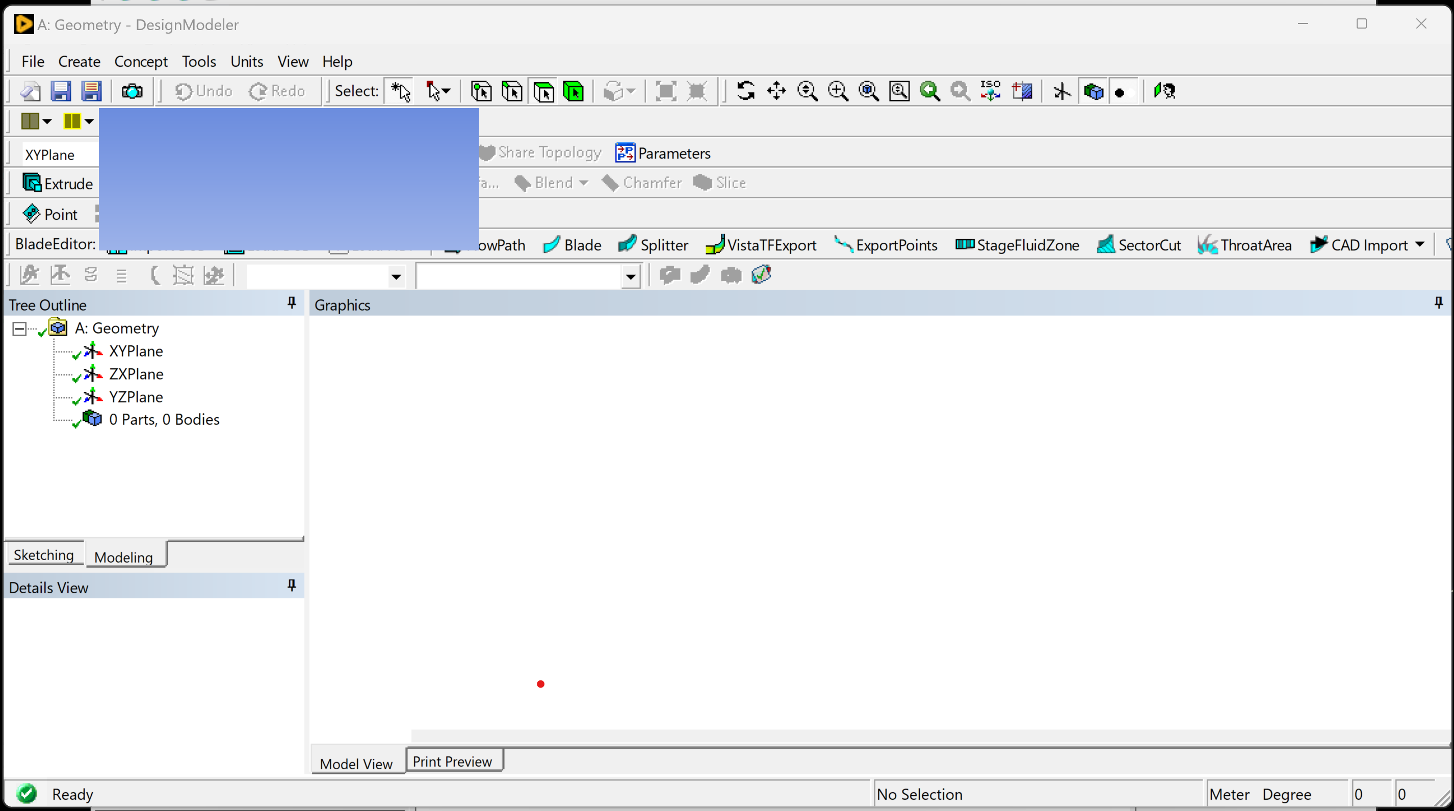

      Hello to you all,
      I have a problem with my DesignModeler interface. The ModelView is smaller and moved in the top left corner of the interface.
      Do you know what should me the problem ?
      I am notacing that I'm using windows 11 and I just upgradet form Ansys 2022 R1 to Ansys 2023 R1.
      Thank you !!!

      Hi Titus Joldos,
      Would you please try resetting the layout? The option can be accessed through View>> Windows>> Reset Layout. For more information please check the following links-
      Reset Layout (ansys.com)
      View Menu (ansys.com)
      Considering your issue, I too tried 2023 R1 on Windows 11, but I did not notice any such layout misallignment. Would you please consider re-installing Ansys products again?
      Please find the Academic Free version for 2023 R1 as follows-
      Ansys Student Versions | Free Student Software Downloads
      Hope this helps!

      Hello Sahil Sura,
      Thank you for the advice. I reinstalled Ansys and now seems to be working properly.
