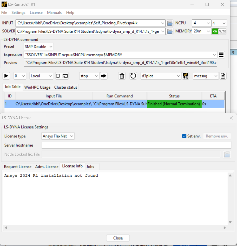

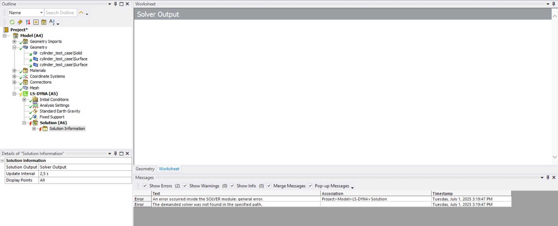

SubscriberI installed the ANSYS Student 2025 R1 package and trying to do a simulation with LS-DYNA at the time of calculating the solution it did not work giving me the following error:
So I installed the latest version available for LS-DYNA Student 2024 R1 installation, and following the installation procedures via tutorial it still does not work.
I also noticed that among the licenses I have:
Could you please give me a solution to this problem? I have already uninstalled and reinstalled everything 2 times.
Waiting for response,
Thanks in advance

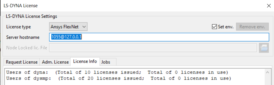

Ansys EmployeeHello, what error do you get when you run the job using LS-RUN? The ls-run windows shows the job terminated normally.Â
To run ls-dyna, please set "LSTC_LICENSE=Ansys" environment variable. Make sure license client (ansyscl.exe) is located in the same directory as ls-dyna solver and make sure your license server is up and running. In the ls-run license window, please define the server hostname (default: 1055@127.0.01).Â
