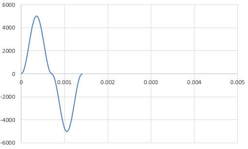

      Hello sean,
      thanks for the reply,
      i have already gone through the same lecture, and tried to do it by creating half sine curve and copied the results in negative direction and obtained the plot, but the full sine curve looks like below snap there is some kind of discontinuity in sine curve.
      that's y i am trying to explore some other methods to do it. in terms of trigonometirc functions etc.,
      saravana
