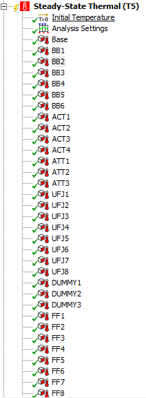

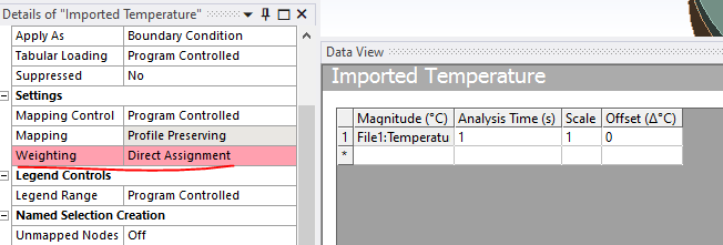

I would like to simulate a thermoelastic problem on Ansys workbench. I have externally determined temperatures that I want to input as boundary conditions in a steady state thermal simulation. For each time step, I have several temperatures to input for the thermal simulations, so for each timestep I can copy the temperature in the tabular environment, like in the picture.
However this is just one of my many boundary conditions, and I have many cases of different temperature fields to run, so I would need to copy and paste a lot of columns. This is a screenshot of the temperature boundary conditions I have to set.
My temperature boundary conditions are stored in a CSV file. Instead of copying and pasting the columns for the temperature as a function of time, I wanted to have each temperature associated with a column in that CSV file. For example the time is equal to the values in the first column, FF1 equal to the values in the second column, FF2 equal to the values in the third column etcetera. So if I change the CSV, I can have the simulation quickly run with the new values.

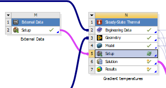

I tried using the External Data block in workbench and it seems to correctly import the data from the CSV:
And I could link it to the model.
However, I cannot use this external data as input for the temperature boundary conditions because the imported temperature cannot be applied because Direct Assignment weighting is not supported.
This is as far as I've got in this problem, there seems to be no possibility of assigning each column of the CSV to the temperature of each geometry object.
Does anyone know a quicker way than copying and pasting the temperatures on each case on each boundary condition?

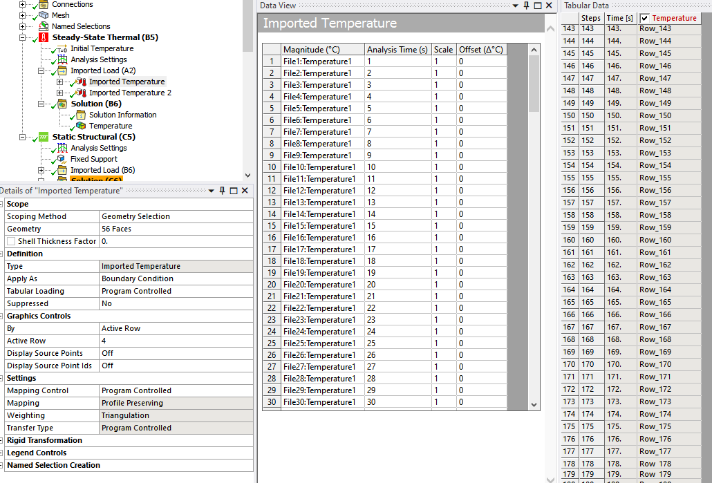

August 4, 2022 at 12:50 pm
Aniket Chavan
Forum ModeratorExternal data can be used to map temperatures on nodes, so along with the temperatures, you should have node locations on which these temperatures are applied as well. Looking at the third image, that does not seem to be the case. What you can do is create a separate text file for each time step, which will contain all the nodes for all boundary conditions and then scope the files to each time step using data view.

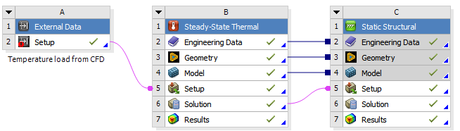

SubscriberHello Victor,

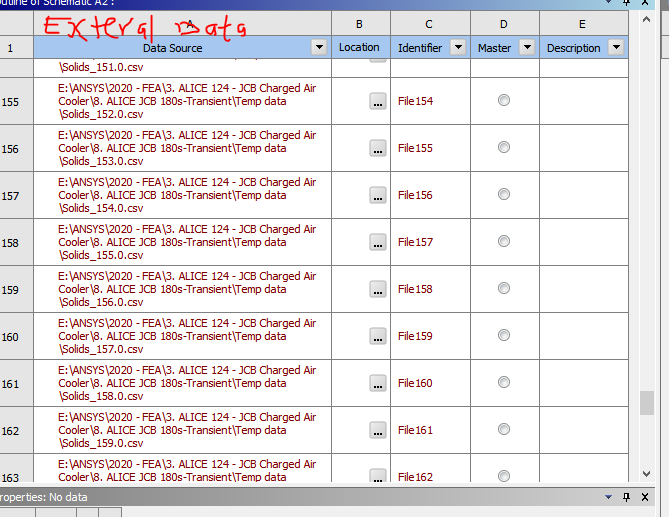

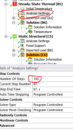

I have performed a similar analysis before where I used 182 csv files (i.e 182 seconds) to map onto my Static analysis simulation.
The mesh and the geometry must be in the same x,y,z coordinate system.
I used the external data as below
This is how csv time 155s looks like. You do the same for all filesÂ

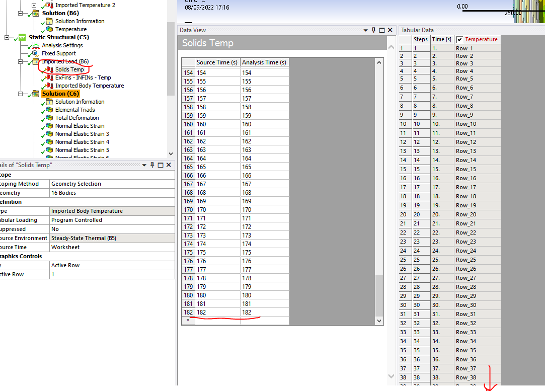

Now back to the mechanical environment the analysis settings for both thermal and the static structural should be set to 182 steps
The imported data looks like this;
Use the same method for the static structural and make sure the time step is set to the same as thermal
You should get something similar to this
Hope this helps
