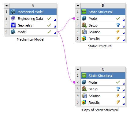

SubscriberThe Mesh component in the Toolbox is for CFD meshing. You made a mistake using that for meshing instead of a Static Structural analysis system. Workbench will not link a Mesh component to a Static Structural model.
It is possible is to have one Mechanical Model, and multiple Static Structural models. This is what you should do.
August 1, 2019 at 11:38 pm
rick825
SubscriberYes this is exactly what I am looking for. Thank You!!!!
