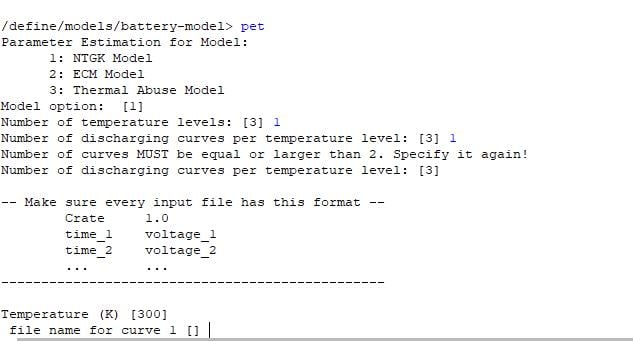

      I am new to ANSYS simulation and I started of duing a MSMD simulation for lithium-ion batteries. By using the NTGK model, I want to define the parameter by using the parameter estimation tool. The console informs that the format should be the following:
      -- Make sure every input file has this format --
      Crate 1.0
      time_1 voltage_1
      time_2 voltage_2
      Do you know how to include the temperature and how many data steps the simulation requires?

      Hello Enav,
      You can use the parameter estimation tool to compute model parameters for the NTGK or ECM model, or for the One-Equation thermal abuse model. You must provide battery's testing data as a text file in a specific format for each model. When you enable this tool and select the model option, Fluent will show the required format for the input file in the console.  For each temperature you need to provide the inputs on time & voltage. For more information, you can refer the below picture.
      Here we need to give input the temperature and curve for time vs voltage. I hope I answered your question.
