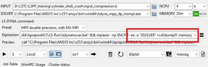

      In order to use simple restart, you will need to create a new input deck with a modified end time (*CONTROL_TERMINATION). Please note that this new input deck should only have modified keywords. In the input field, you should point to this new input deck with modified keywords (in your case only *CONTROL_TERMINATION), and in the expression field, replace i=$INPUT with r=d3dump01 in the command line of LS-RUN, such as below:
      Always make sure to use the same solver settings (Version, cores, precision, MPI).

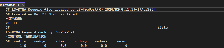

      Thank you for your explanations. I am still not completely clear about creating the new deck. I have prepared one as you described and included a screenshot below that contains only the modified keyword. Is this correct?
    • Nanda
      This looks correct. Please proceed and let us know if you run into any issues.
