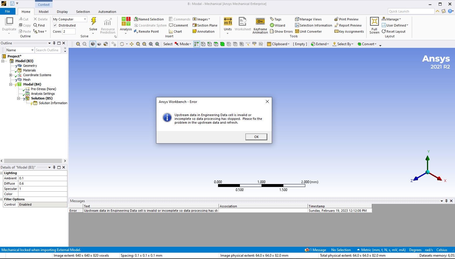

      I tried to import the file into Ansys workbench first, and then convert the file into some format that is compatible to Ansys HFSS.
      However, I got the following error message.

      Please note that the Ansys Electronics Desktop projects are saved with ".aedt" format but not with ".ans" format. Hence it is not been able to open. It is suggested to check with the other tool on its file formats.
      If you want to import the model geometry created in other tool, please look at this link for the supported formats for model import - Ansys Electronics 2023 R1 - Working with Ansys Electronics Desktop Projects.
