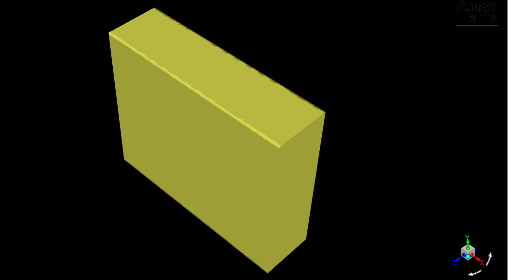

AdministratorHello Are the inlet and outlet boundaries specified on a solid object? Also, are these external boundaries for your computational domain?
Karthik
January 18, 2022 at 10:27 pmcnorrie5
Subscriberthe yellow box in the first image is the domain

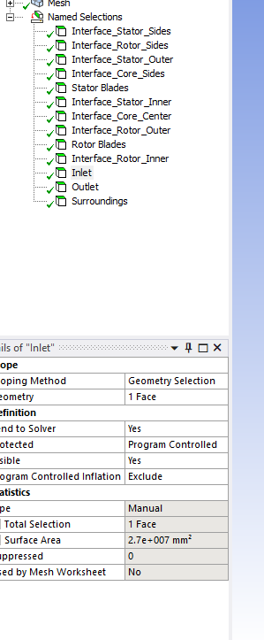

January 18, 2022 at 10:33 pmKarthik Remella
AdministratorAnd could you please point me to the Inlet & Outlet boundaries in Ansys Meshing tool?
January 18, 2022 at 11:31 pmcnorrie5
SubscriberFar end is inlet near is outlet in the yellow picture

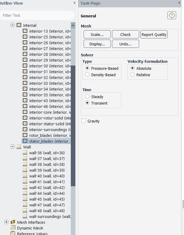

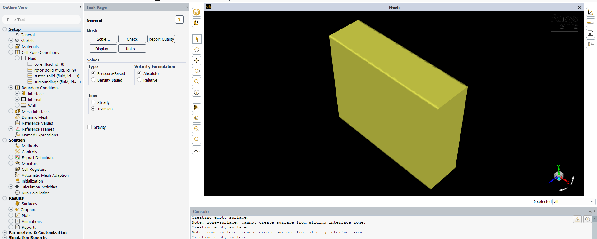

January 19, 2022 at 12:01 pmRob
Forum ModeratorYou're in Workbench Meshing, and the surfaces look OK. However, you also have four parts, is that correct?
January 19, 2022 at 12:11 pmcnorrie5
SubscriberThe top image is from Fluent the bottom is from Meshing, Yes I think so. I was advised to manually input my contact regions to solve my mesh interfacing issues.
January 19, 2022 at 12:20 pmRob
Forum ModeratorYellow in Fluent implies an interface zone. Please post the boundary condition & cell zone list from Fluent so we can see what's going on.
January 19, 2022 at 12:34 pmJanuary 19, 2022 at 12:35 pmJanuary 19, 2022 at 2:55 pmRob
Forum ModeratorThat's odd, the surface labels should pass to Fluent. If you click on the inlet label in meshing how many faces are in the zone?
January 19, 2022 at 4:06 pmJanuary 19, 2022 at 6:28 pmRob
Forum ModeratorAnd no wall-surroundings. If you click on File - Export what do you see when you read that mesh into Fluent standalone mode (instructions at the top of the Fluids section on how to do that).
