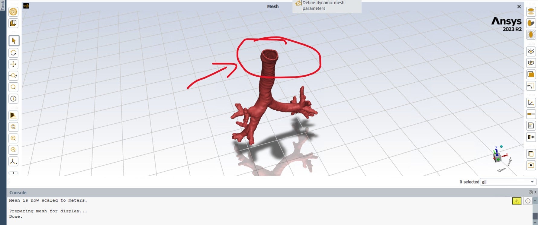

Does anyone know how to make an inlet into this region?
I am trying to simulate human airway inhalation.
I am trying to make an inlet for this model but as you can see, the inlet is not normal shape and hard to select as inlet layer.
Besides, if you ever made human airway simulation, please share your workflow and experience. I really appreciate it.

The image you shared, is this the fluid domain? Did you extract the fluid domain successfully?

SubscriberHi,
No, not yet. What does it mean? and How can I do that?
February 21, 2024 at 4:38 pm
Essence
Ansys EmployeeYou need to first extract the fluid domain in SCDM or Discovery and then mesh the fluid domain. Then this mesh needs to be imported to the Fluent solver. However, you can also extract the volume in Fluent mesher. I would recommend you to go through the AIC courses which demonstrate the same.

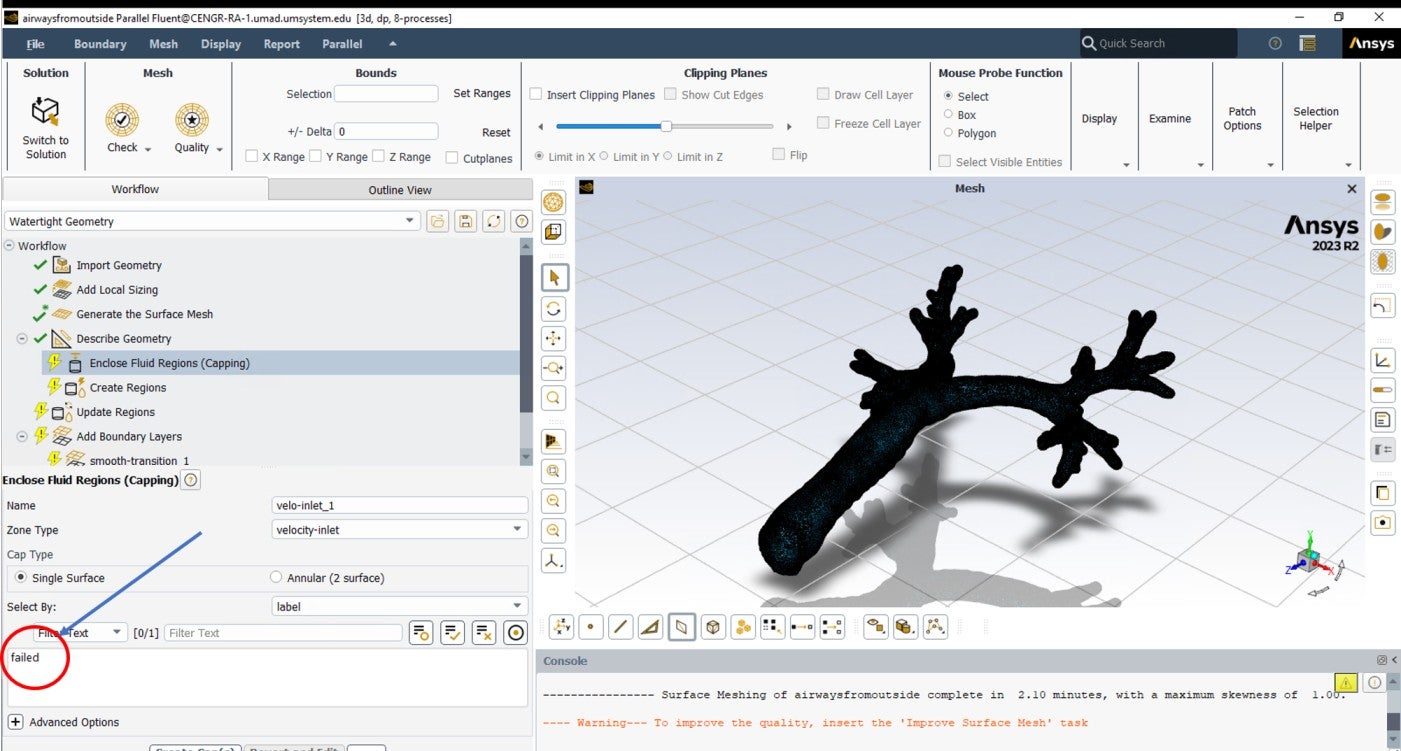

Besides, is volume extracting this step (picture below)? If yes, my whole object is defined as a single regions only. How can I separate my object into multiple regions (like inlet, body, etc.) for my purposes?

dungnguyenxuan199566
SubscriberHello Rob,
Thank you for your explanation. Would you mind explaining in more detail in this step " capped those in the geometry/meshing tool"?
I think this is the step where I am stuck in. That would be great if you could attach some pictures. When I import my stl file in fluent mesh, it shows as one single object and I cannot select the inlet (top). What I did was:Â
1, Open workbench, select, geometry, then import stl file.
2, Select edit in Spaceclaim, in the Spaceclaim, I select autofix in facets tools.
3, Then, I move it to fluent mesh.
but in the fluent mesh, I could not select inlet regions for capping (as inlet), please find pictures below.
February 23, 2024 at 10:06 am
Rob
Forum ModeratorYou currently have a solid zone that is the lung wall. When I did the work I trimmed the geometry to have a single shell surface with holes where I wanted the flow. These were capped & labelled so when moving to TGrid (now Fluent Meshing) I had zones for wall, inlet & 8-16 outlets. Much mucking about was then done as the tools have improved in the last 20+ years and 2 weeks later I had a tet mesh.Â

SubscriberWould you please specify " trimmed the geometry to have a single shell surface with holes where I wanted the flow" and "capped & labelled" steps? Did you do this before exporting stl file or after you have stl file. And which software did you use to trim and capped, labelled the geometry? Is there anyway we can trim, cap, and label the stl file?
February 26, 2024 at 10:26 am
Rob
Forum ModeratorThe artery/lung you have looks to be a solid volume of the vessel wall, ie it has a thickness. In my model we had a single shell (surface not volume). I trimmed the ends off in Magics (Materialise product) to import just the wall into GAMBIT (very old Fluent pre-processor). I then capped the ends, remeshed and fixed the geometry with a mixture of GAMBIT and manual node repairs in TGrid (now Fluent Meshing). This took several weeks.Â
Your approach now may be to tidy the stl up in whatever you used to generate it (Magics or Simpleware [Synopsys product] would be my choices now except I don't have a licence), cap the ends in SpaceClaim and then mesh.Â
SubscriberHi Rob,
I agree, mine is volume one. Can we do something like converting the volume solid one to a surface one?

Rob
Forum ModeratorTo convert you can throw away one of the main faces, but which one is up to you. Hence me suggesting looking at whatever software was used to generate the stl.Â
