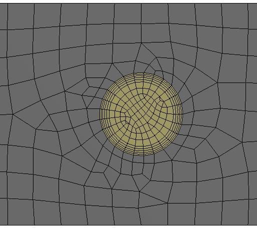

SubscriberCreate a Multi-body part in DM by selecting the four solids and Form New Part.
In Mechanical, define the three rods as Fluid, repair the Named Selections. If you get an automatically generated Contact, delete it.
Use a Sweep Method on the fluids and use Inflation on the circular holes.

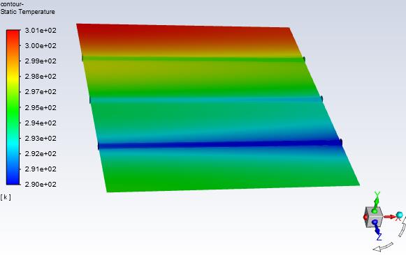

Here are the contours of temperature on a plane at the center of the block.
If you cut the inlet mass flow rate by a factor of 10, then you get an x gradient.
