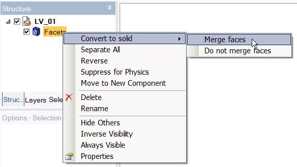

      Hi all.
      I created an .STL file by segmenting a CT dataset in 3D Slicer. I imported it into SpaceClaim and used shrinkwrap. Using tetrahedron meshing, I was successfully able to generate a mesh.
      However, when trying to select the inlet and outlet, it just selects the whole body. How do I define an inlet and outlet once I have used shrink wrap? For some reason it won't let me and when I try to separate it in SpaceClaim, I am not successful.
      Thanks in advance.
      (I can provide the .STL file if needed)

    • Sandeep Medikonda
      aginn,
        You just have a bunch of facets (small triangles enclosing the body) when you have both an STL or a Shrinkwrap. From what I understand you need a Solid or Surface body with some thickness?
        Right click on the STL/ShrinkWrap and convert it to a Solid body or use the 'Fill' tool, you might also find this thread useful. Once you have a solid body, using the 'Shell' tool in the Design tab make it hollow as needed. Create Named Selections in Mechanical for the Inlets and Outlets in mechanical to apply your boundary conditions.

      aginn,
      Note that 19.0 can't open files created by 19.1. I have both available so I needed to know exactly which one and it looks like you have 19.0
      Sandeep has provided lots of great resources, but the key is that you want a solid model, maybe hollowed out, and not the STL facets that you have shown. I am learning how to handle STL files so I am going to try to make that solid model, but don't wait for me if you learn what you need to from Sandeep's resources.
      Peter

      This looks like a heart, since it has an aorta. What is your simulation goal. What wall thickess would you use to hollow out. If it is a CT image, the wall thickness would be visible in the image and a surface of the interior wall could have been made.
      There is a warning message about increasing the size of the model by orders of magnitude. I'm still waiting for that to finish.
      The problem you will face is that the resulting solid will have many more than the 300 faces that the Student license limit allows. I am fortunate to have two computers, one with a full license and another with the Student license.
      You need to bring the STL file into another CAD system, not SpaceClaim, and convert it to a solid using shrinkwrap-like methods in that CAD system to replace hundreds of facets with a single b-rep curved surface, and a collection of those surfaces, but < 150, will define the outside surface. When you hollow out the interior, the number of surfaces will double.  Each surface counts as a face.

    • aCVP
      Thank you for your reply! I was able to gain access to the full version of ANSYS through our IT department on the university server, so the face limit is no longer a problem.
      For anyone with the student version subject to the limitation:
      -Rhino Resurf can automatically generate a surface from a mesh
      -ANSYS Reverse Engineering "Skin Surface" tool works but is VERY time-consuming to complete
