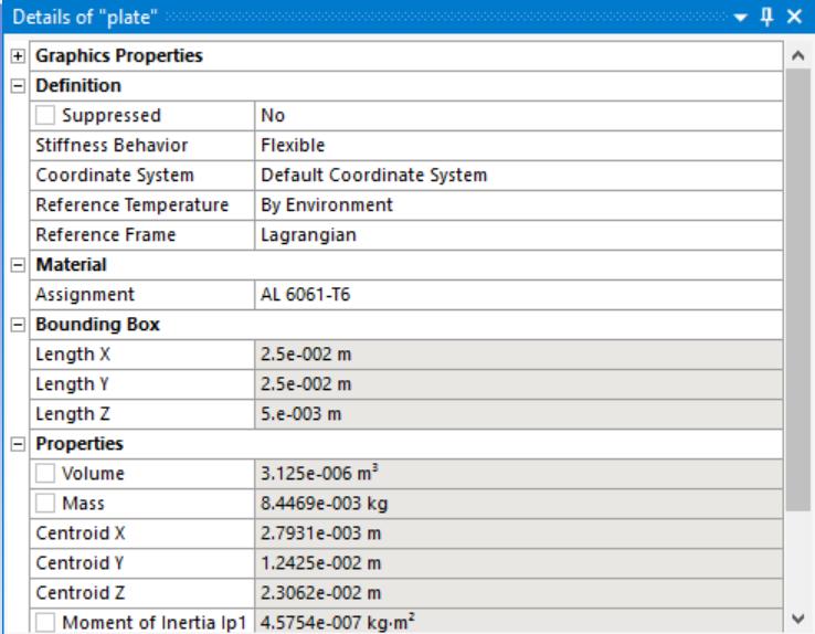

      I have one more question to you that how to calculate the mass of a plate if there is some erosion (some element loss) . I am using "massall" expression but result is not satisfactory because mass shown in geometry and mass calculated through massall expression are not matched even there is no element loss or erosion.

      I inserted your images below because ANSYS staff are not permitted to open attachments.  I haven't used the MASSALL() command, so I don't know what it does. Since the number is larger than the plate, does it include the mass of the particles?  What does workbench show as the total mass of the model?

      Yes , mass of particles are included with plate.
      I have to calculate the  mass loss of the material (say plate) after the impact of the striking of some object (say balls) . here target material is flexible and striking object is consider as rigid body. Using the erosion expression in user defined result I am able to calculate the element loss but not getting the way to calculate the loss of material due to the impact of the particle.
      Erosion= mass of plate before the impact- mass of plate after the impact
