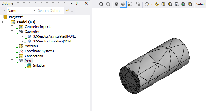

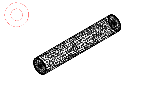

      The geometry is shown here with a rectangular prism representing fluid completely encasing a solid cylinder. I am trying to set up inflation for the mesh for both the cylinder and the surrounding fluid but whenever I select the cylindrical faces of the cavity within the fluid for the solid cylinder the following mesh forms. It seems to invert the direction of the mesh. Is this a setting that I need to adjust or is my geometry unsuited for inflation meshing?

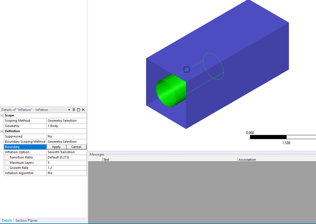

      I assume you have a volume for the outer section too? When you add the inflation which volume is it attached to?
    • T-Ying Lin
      When I add the inflation, it is attached to the outer volume and produecs the displayed mesh. I know this for certain.

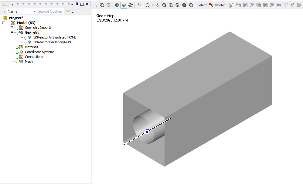

      Assuming you're in Workbench Meshing you should see two volumes in the geometry part. Hide the cylinder then set up the inflation. Then see what happens.
      • T-Ying Lin

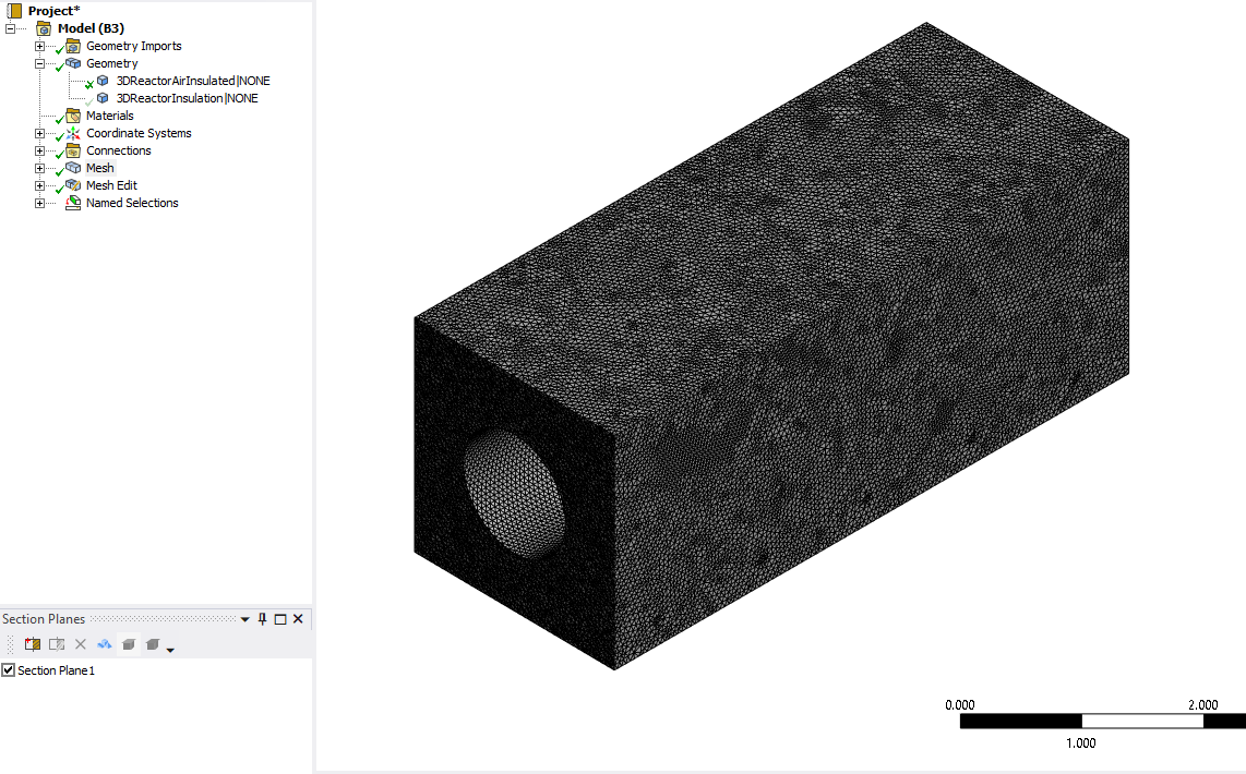

        Upon hiding the cylinder, I set up a section plane so I can see the internal cylindrical walls and set up the inflation, the same problem with the mesh appears.
      Weird. Can you leave the cylinder hidden and just mesh the outer region (right click mesh selected object)?
      • T-Ying Lin
        When I mesh the outer region without the inflation, the mesh forms normally. While I could mesh this a consistently finer mesh throughout the entirety of the volume, I was hoping to reduce the number of nodes that I would need (for obvious reasons).
