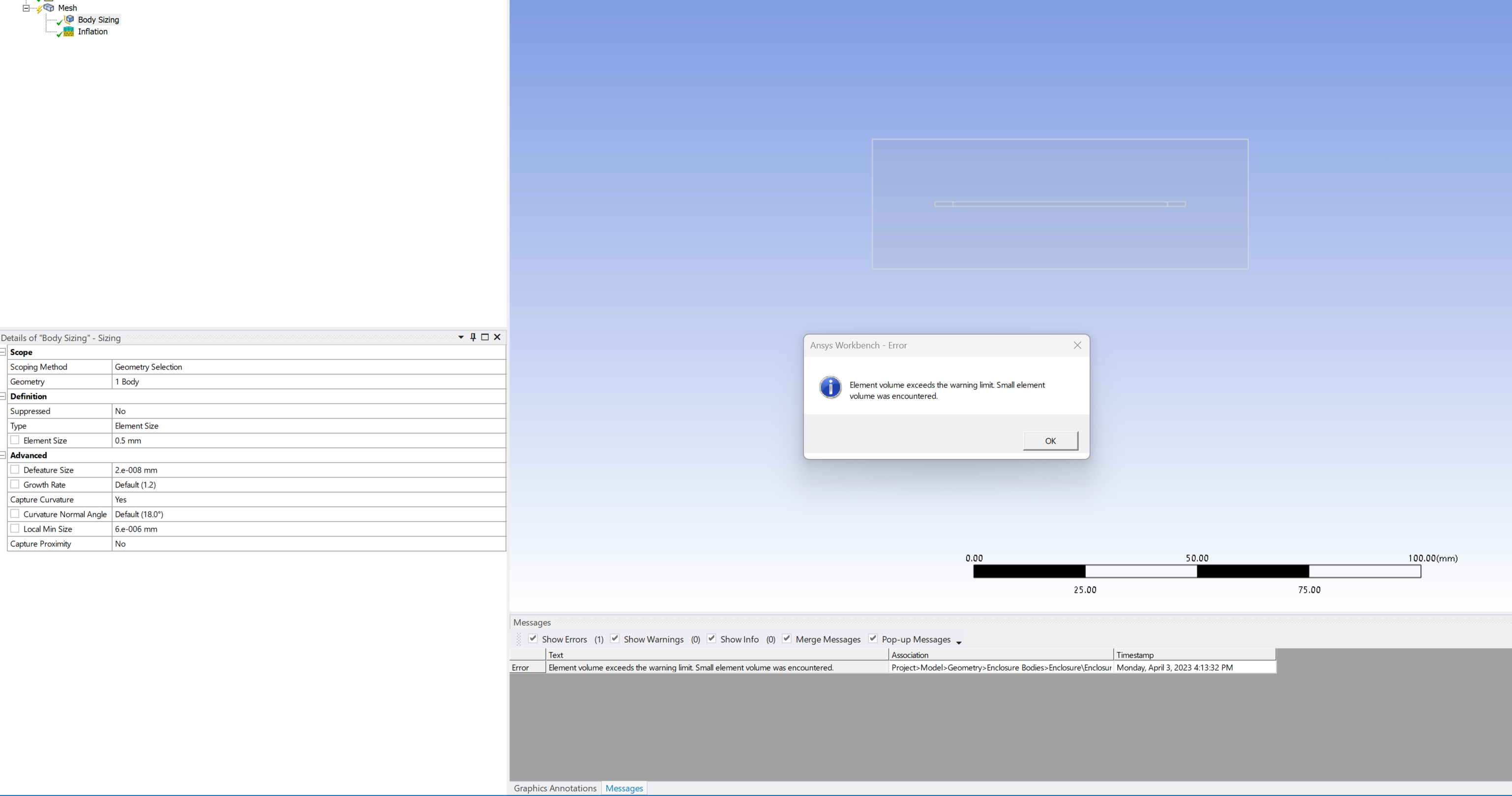

      my mesh is ok but any warning like this(inflation created stairstep mesh at some location & element volume exceeds the warning limit. small element volume was encountered)

      Use the "insert image" option.  Not sure why element volume would trigger a warning, can you post an image of the warning too?

      this my warning image

      if mesh orthogonal quality is is ok then you can proceed.
      make sure that min orthogonal quality is greater than 0.1

      I encounter the same problem of element volume exceeds.
      Any hint for solving this problem?
      Please find the attached photographs.
