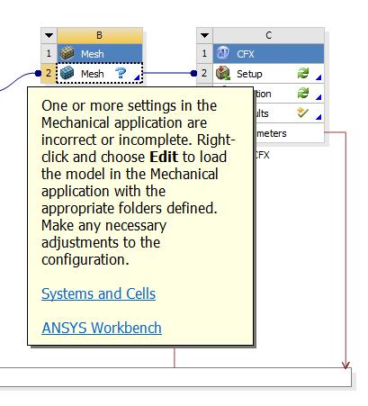

I am trying to set up an automatic process with Ansys Mesh using imported geometries via SpaceClaim by varying the parameters.
The named selections are also imported and all mesh settings choose their named selections automatically except the boundaries in the inflation option.
To be more precise, the named selection is chosen but with a yellow background color so i have to check again manually as you can see in picture 1.
As in the ansys manual described, i have changed to option "programm controlled inflation" to "include" within the named selection as you can see in picture 2.
I would be really grateful for your suggestions to solve this.
Best wishes
Bastian -

Forum ModeratorSetting the NS should work. I always make sure all the automatic inflation options are off. Can you check the surface labels came through OK?

SubscriberHi,Â
many thanks for your reply. What does NS mean? The automatic inlation option has to be switched off within the general mesh settings, right?Â
I am pretty shure the surface labels came through correctly as I have to select exactly the same named selection manually.
This means after selecting it manually, in the "Boundary" row appears exactly the same name of the named selection as you can see in picture 1 above with the difference of a white background color instead of a yellow background.

Forum ModeratorNS - NamedSelection, I'm lazy..... Yes, turn off automatic inflation.Â
Double check the surfaces, along with any in the other groups. I've not heard of any issues so please check through carefully.Â

SubscriberHi,
I turned off the automatic inflation:
Then I updated the geometry by changing a parameter. The following message appeared as before for the meshing part:
Checking the named selections, it turned out everything is alright but the named selection for the inflation boundary has still a yellow background:
Have a closer look on the named selection "InletDomain_InflationCoarse" with the yellow background above. After selecting manually the same named selection again, the backgound color became white and the meshing was carried out correctly:
It is a bit weird... My intention is that the named selection are selected automatically for the inflation boundary. Remarkably any other named selection is selected automatically e.g. for face sizings and so on.

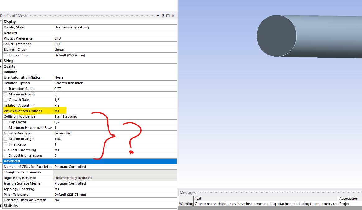

SubscriberAfter updating to Ansys 2019 R2 (this seems to be the latest release available on the website) the issue is still persistent like desribed above.
- automatic inflation is switched to "none"
- program controlled inflation is switched to include within the named selections
- after updating the geometry, the boundary still has the yellow background. After clicking on it again manually it becomes white and meshing is done correctly. But this manual step has to be done with every geometry update.

Forum ModeratorTurn off program controlled too.Â

Forum ModeratorYes. But also open up the Inflation -> Advanced options.Â

Forum ModeratorOK, wanted to check there wasn't anything in there.Â
Have you spoken to your supervisor? As it's working here I'm not sure what the problem is. Â
