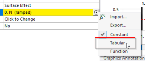

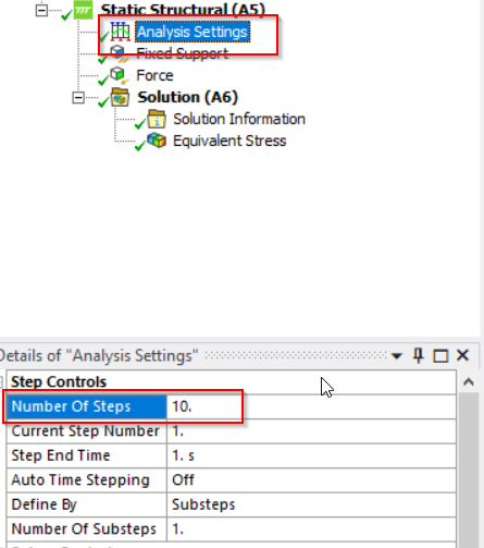

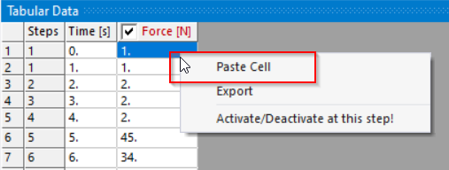

You can copy-paste your loads from excel to the force load. To do that, first, go to the analysis settings under the solution branch and mention the number of steps (loads) in the number of steps option. After doing that, insert force load and change the magnitude type to tabular. Copy the data from excel and select the first cell of the force load, right-click and click on the paste cell. This should add all the force loads in the column. Please refer to the pictures.
Hope this helps.
