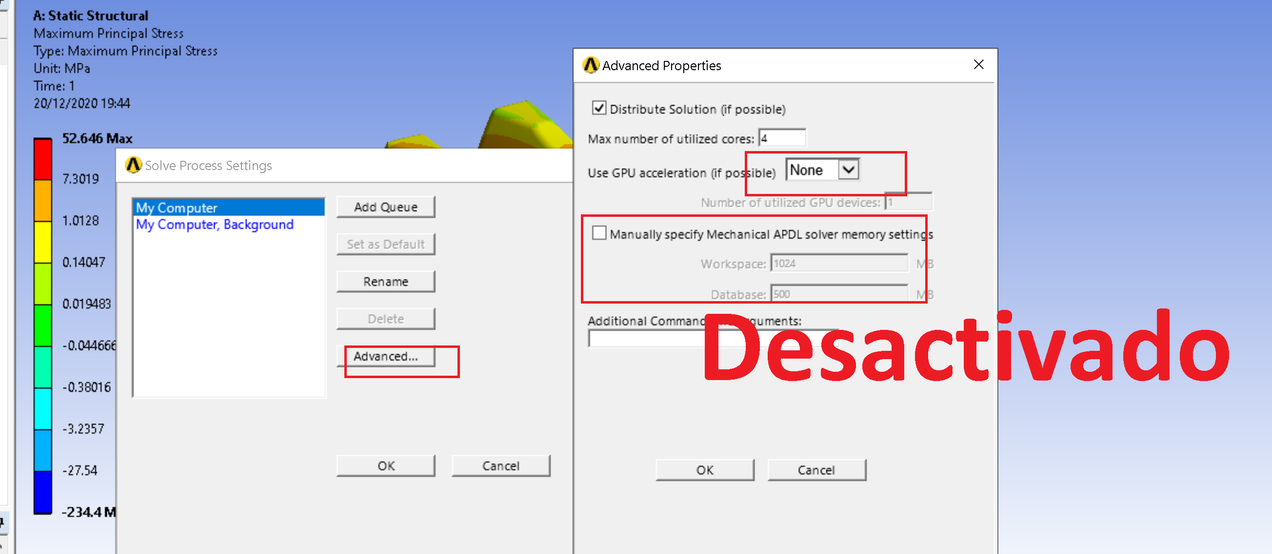

I have been having issues with the memory for quite some time due to my comprehensive model. It has quite large at 2.5 million nodes, but the details and contact pairs necessitates a fine mesh.
To mitigate the issue, I have already tried the following
- running iterative solver
- running out of core
- increasing virtual memory
- using msave
however, even after all this I still get the error message:Â
"There is not enough memory for the Sparse Matrix Solver used by the PCGÂ
 solver to proceed using the out-of-core memory mode. The total memory Â
 required by all processes = 186543 MB. The total physical memory that Â
 is available on the system = 115895 MB. Please decrease the model   Â
 size, or run this model on another system with more physical memory."
Currently, I have 125GB physical memory and just added 80GB swap memory. However, the error message only reflects the physical memory while I have ample hardware to meet the requirement of 186543MB.Â
I already allocated all the RAM in 'solve process settings' yet this issue is still persisting.
Please help and thank you,
Andy
May 3, 2019 at 3:16 pm
peteroznewman
SubscriberWhat do you mean by this?
You may be causing your own problem. Please show the solve process settings you have been using.

SubscriberYou are causing your own problems. You have 125 GB of RAM and you allocated 200 GB of RAM for Workspace and 200 GB of RAM for Database. Don't do that, it is the cause of the error. If you are interested, read ANSYS Help on Memory Management. Here is a useful paragraph:
Mechanical APDL memory is divided into two blocks: the database space that holds the current model data and the scratch space that is used for temporary calculation space (used, for example, for forming graphics images and by the solvers). The database space is specified by the -db command line option. The initial allocation of total workspace is specified by the -m command line option. The scratch space is the total workspace minus the database space.
In general, specifying a total workspace (-m) or database memory (-db) setting at startup is no longer necessary. Both the scratch space and database space (64-bit systems only) grow dynamically, provided the memory is available when the memory manager tries to allocate additional memory from the operating system. If the database space is unavailable (or forced not to grow dynamically via a negative -db value), the program automatically uses a disk file (.PAGE) to spill the database to disk.     Â
I have never had to Manually specify Mechanical APDL solver memory settings on a well equipped computer. The only time I did was to help a student on an old computer with only 2 GB of RAM, while ANSYS specifies the minimum RAM is 4 GB. The default setting for Database is 2 GB of RAM which caused the same error you saw on a computer that only has 2 GB of RAM. To help that student, I recommended 1 GB of memory for the Database and that allowed that small model to solve.
What is the error you get when you uncheck Manually specify Mechanical APDL solver memory settings?
