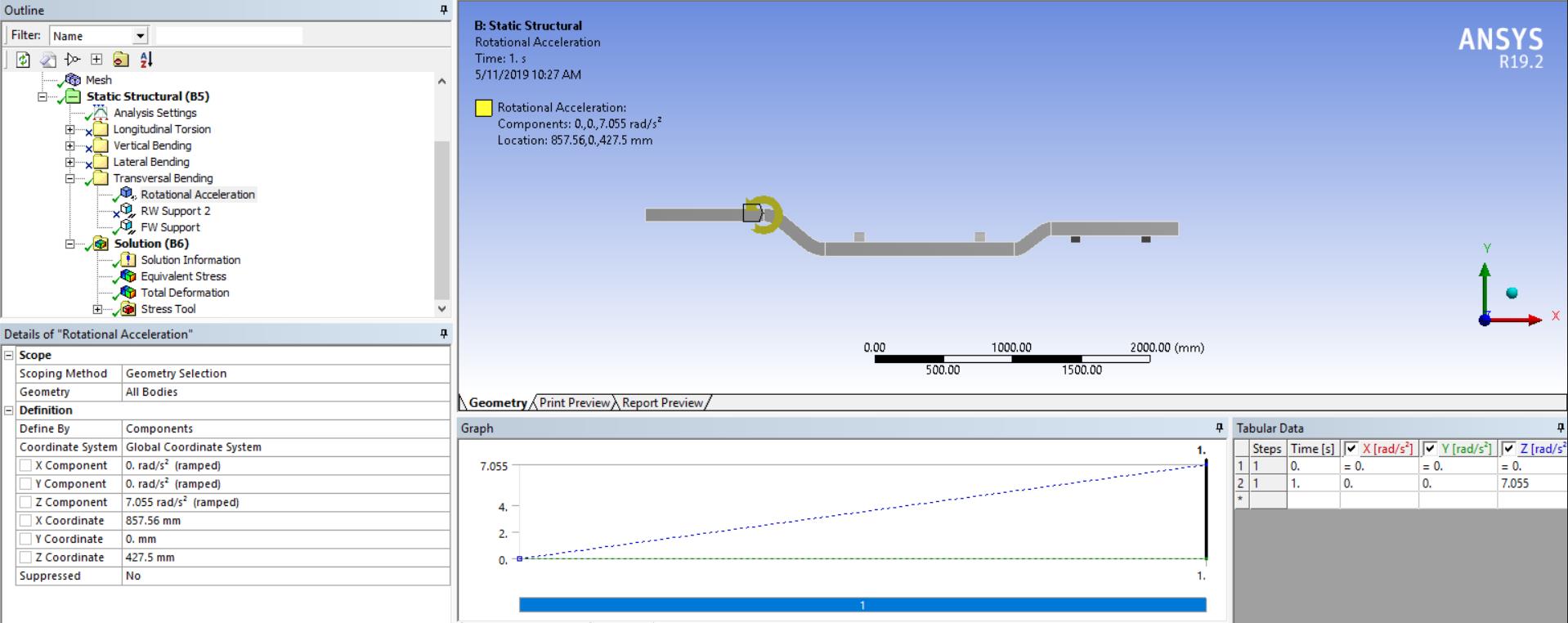

      To be clear I am dealing with a ladder chassis. Another situation is when the car decelerates the car the rear end bend toward the front end transversal bending to the side beams. so I apply a rotational acceleration about +ve Z  and support at the from wheels mounts. what I get is a rotation (in the animation) about the -ve Z axis.

      It's still not clear what you put in your model, what the results are and what you expected.
      Please capture a screen image using the Snipping Tool in Windows 10. Once you save a screen image to a file, you can insert the image in your reply.

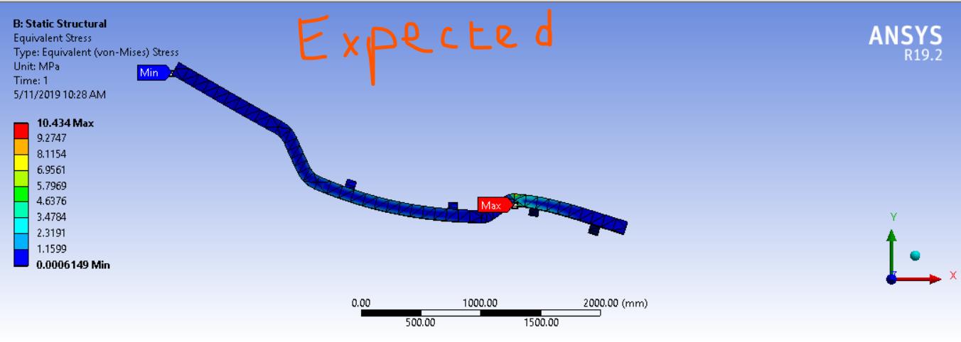

      The load direction should be about -ve Z but I inverted to show the expected deformation.
      This is what I expected as the car decelerates.

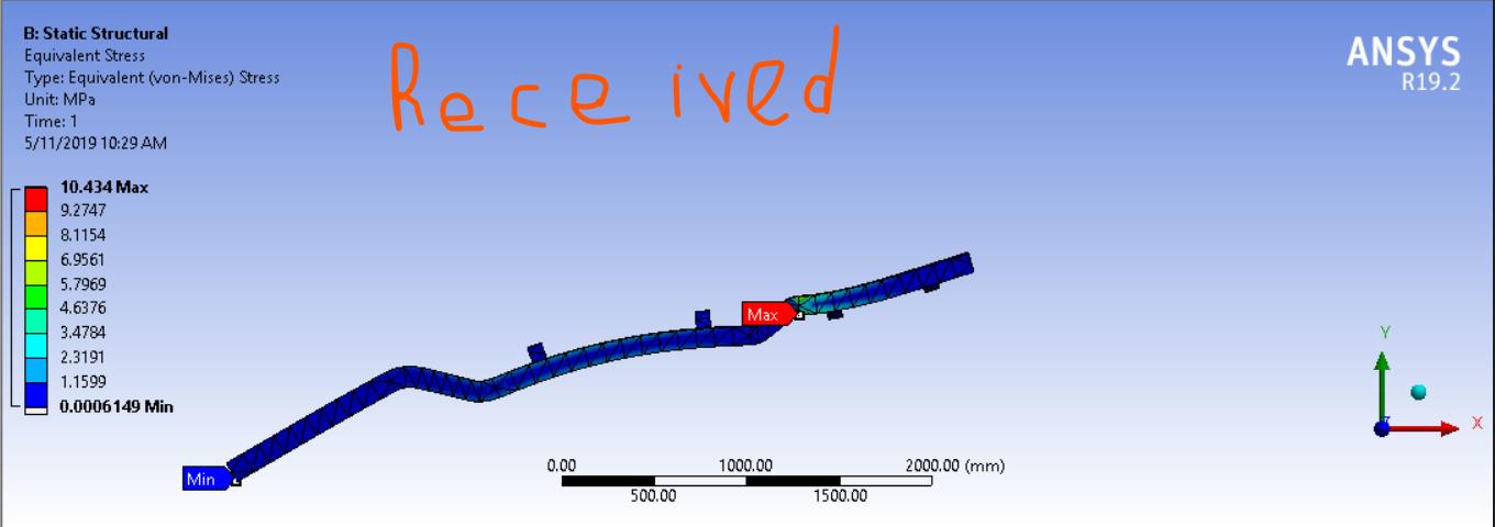

      This is the result when I set the load in +ve Z direction.
      What you received is what I expect. By rotationally accelerating a beam about a point at the left end, the mass at the right end is going to lag behind, pulled by the inertia forces.
      Imagine you have a very flexible steel ruler, the long direction along the x axis and the thin dimension aligned with Y so the ruler lies in the XZ plane. At the left end, the ruler is fastened to shaft with a crank handle. A large mass is attached at the right end. Suddenly turn the crank about +Z and imagine what happens. The mass will lag behind and the ruler will bend the way the frame did in the received image.
